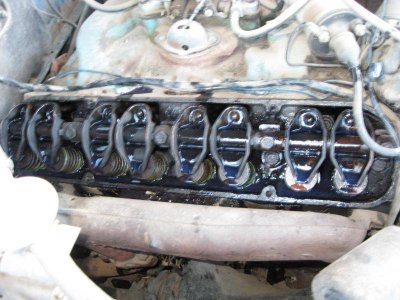

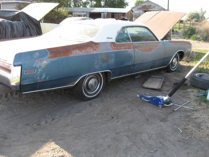

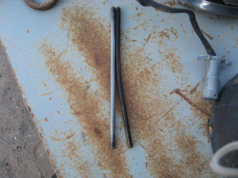

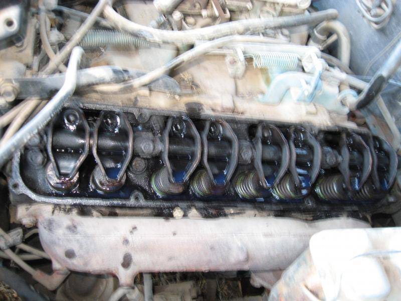

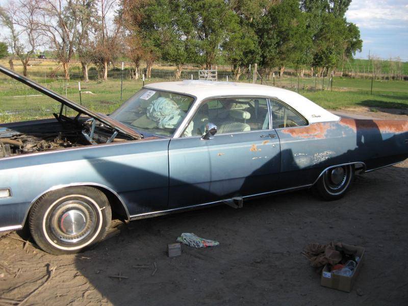

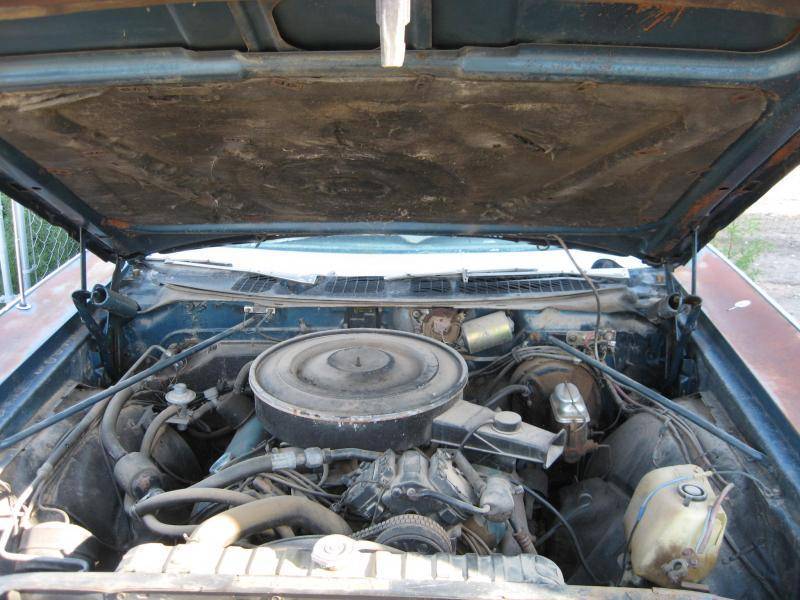

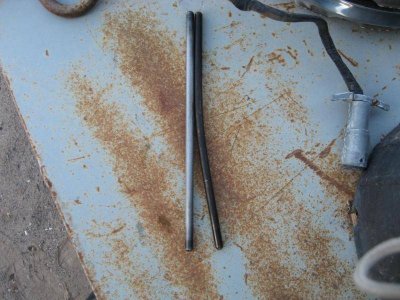

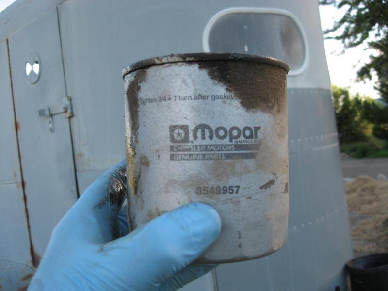

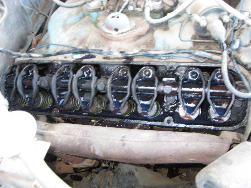

car photos 023.jpg002.jpg002.jpg005.jpg006.jpg007.jpg009.jpgWell I finally started on my other "Kee" car the blue one. First pulled the oil filter it was a mopar filter awesome, bad news is that I smelled gas in the oil filter will need a fuel pump. Next I pulled the valve covers to prelube the rockers more bad news bent push rod (#6 intake ) I decided to stop for the night, I want to take a peek at the lifters and it got to dark more news Tuesday. Here are some pix From where it all started to today

Good work. When I see a bent push rod like that, it can suggest someone tried to run the vehicle on old gas. The varnish in old gas will cause valve stems to seize in the valve guides, leading to a bent push rod, especially with a low mileage engine (what does the odometer say in your car?). I would remove the rocker shaft/arms on the side of the engine with the bent valve and check movement of the valve that had the bent pushrod. If stuck, I would put some penetrant such as carb cleaner in the stem area and let it soak. Then after a day or so, go ahead and try to loosen the valve by tapping on it with a hammer as needed to loosen it. Once it is free put a new push rod in place and you might get lucky. I have had this situation several times when I bought a vehicle that someone had tried to run on old gas and this technique worked - the engines were all running well. Good luck.
This isn't Tuesday but here is an update. First don't hate me for this next sentence. Since the valve is stuck good, I am going to remove all the parts that I need for my vert (am/fm 8 track,power ant remote trunk release, various under hood stuff) also the motor will be removed for future rebuilding. Now the good news I have a friend that wants the car for his daughter and I'm going to accept a trade for a rebuilt 413 for my 62 chrysler. We will be installing a running 440 into the 300 so the car will live again

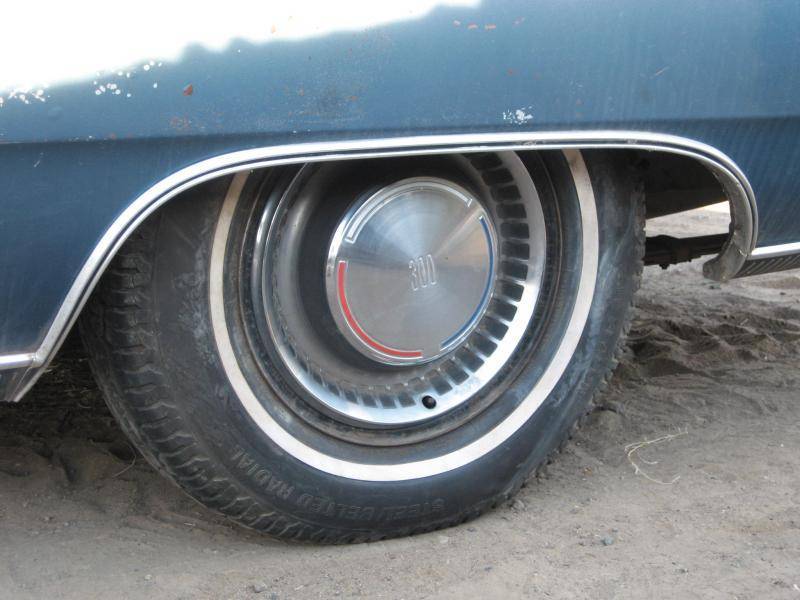

I decided not to remove the remote trunk release as it is vacuum operated or the power ant. But I did remove the am/fm 8 track I discovered the radio came from a 69 town station wagon. Also I put new shoes and caps on her.002.jpg004.jpg005.jpg
Geez... That girl sure won't appreciate that nice wheelwell and rocker trim like I would....
