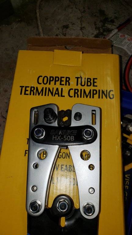

    Hi forum! today i test out the sanuke lug crimping tool for your viewing pleasure. it was a blamazon purchase. came with like 10 lugs to start you off with.
    this thing:

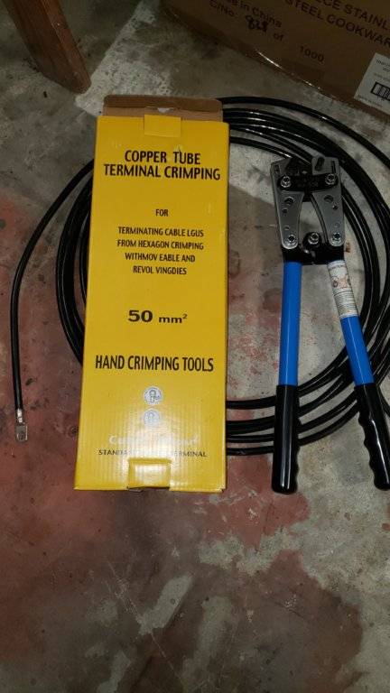

    lets start with the on-the-box description:
    COPPER TUBE TERMINAL CRIMPING (copper tube??)
    FOR
    TERMINATING CABLE LGUS (what the hell is a lgus???)
    FROM HEXAGON CRIMPING (ok i guess...)
    WITHMOV EABLE AND (holy crap ya got me there)
    REVOL VINGDIES (im gonna revol my vingdies?)
    50 mm 2 (canadian stuff)
    HAND CRIMPING TOOLS

    ok - now there are no paper instructions, and i have never operated one of these before. tbh i went and DDGd up a how to video from someone. you push down the spring pins in the head and change the die around to the size you need. then open the jaw, put the lug in, close jaw until it has ahold of the lug. put your wire in the end of the lug. compress.

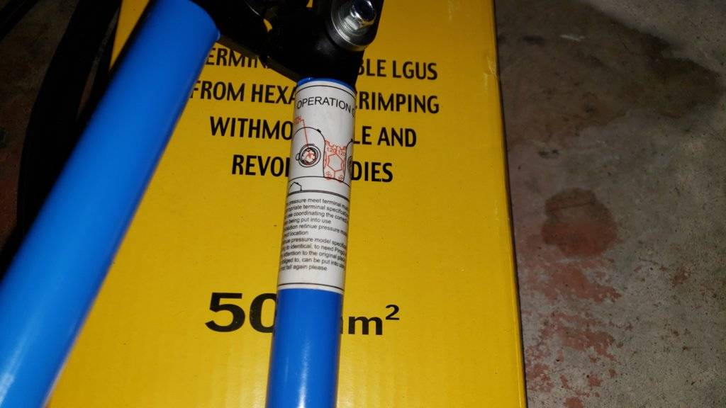

    anyways - back to the instructions. there is a sticker on the handle. lets read it so we dont pinch our finger or anything:
    OPERATION GUIDE
    1. The pressure meet terminal must select and use appropriate terminal specifications first being put into use coordinating the correct implement again when being put into use
    2. Revolution retinue pressure model arrives at correct location
    3. retinue pressure model specification must be going to identical to need Pinggl who plasec
    4. Pay attention to the original place placing the latch be obliged to can be put into use just now
    5.) Do not fall again please

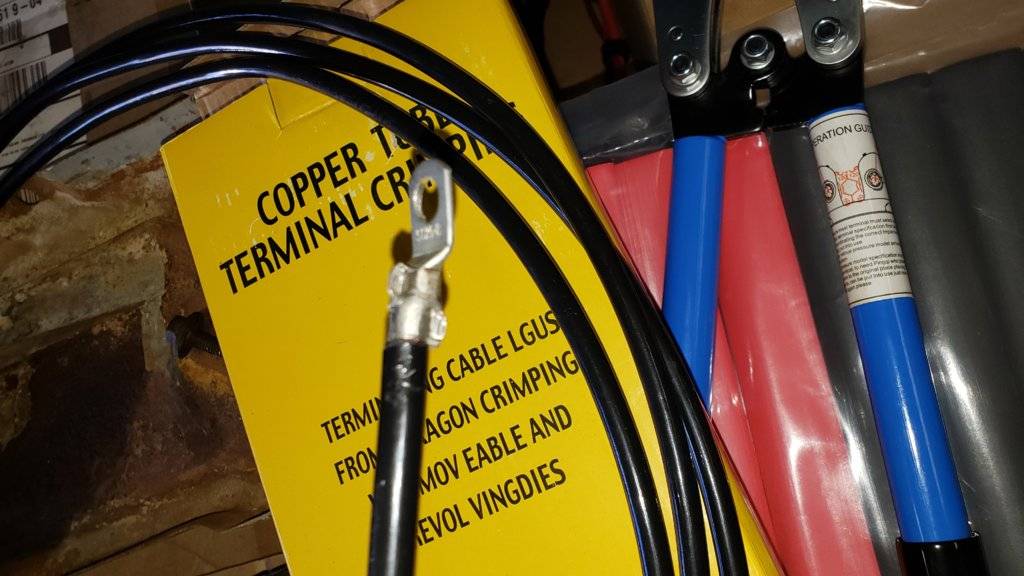

    here is the first finished crimp on 4 AWG wire with one of the lug ends that came with the kit.
    it kind of pinches up the top and smushes the bottom sorta. this wire has 2 crimps i turned the wire 180 over and crimped again:

    so i get out there today to do some crimps, and i notice
    lookit the right side crimper. the spring and c clip are not there. at some point during the night it shot off there into space. somewhere in my garage. no idea where. could be anywhere hope i dont step on it. ill be sending it back and getting the IWISS i guess...

    4 awg wire is not equal 50 mm crimp . to crimp a 4 awg wire in MM it is equal to 25 MM Crimp thats way you have the big ears from the crimp and that is no good

  20. ricks_RR
    ricks_RR Well-Known Member
    Messages:
    572
    Likes Received:
    475
    Joined:
    Mar 19, 2015
    Location:
    n.h.
    that was my next question does the dies turn for different sizes when you are crimping a lug you don't have to turn it 180 degrees make sure your first crimp is on the opening of the lug where the wire go's in because when you crimp it the copper is going to expand so when you crimp the second crimp which will be in the middle of the lug it will help fill the lug with the expanding copper and you will have a good connection as long as you use the right size wire and lug
