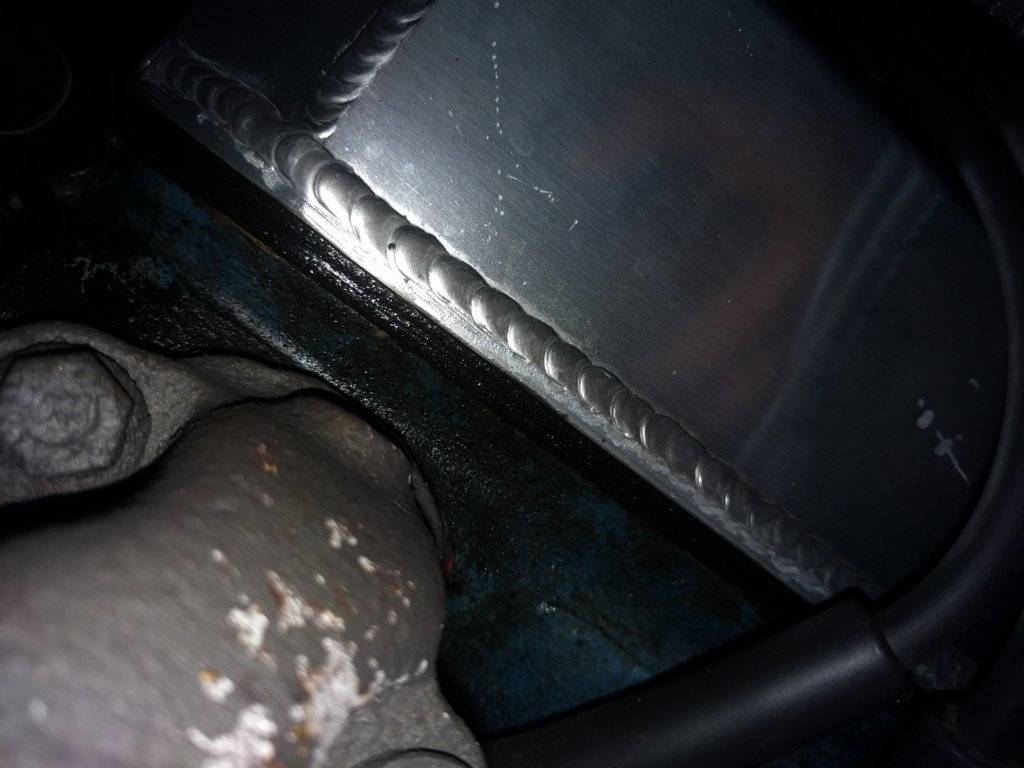

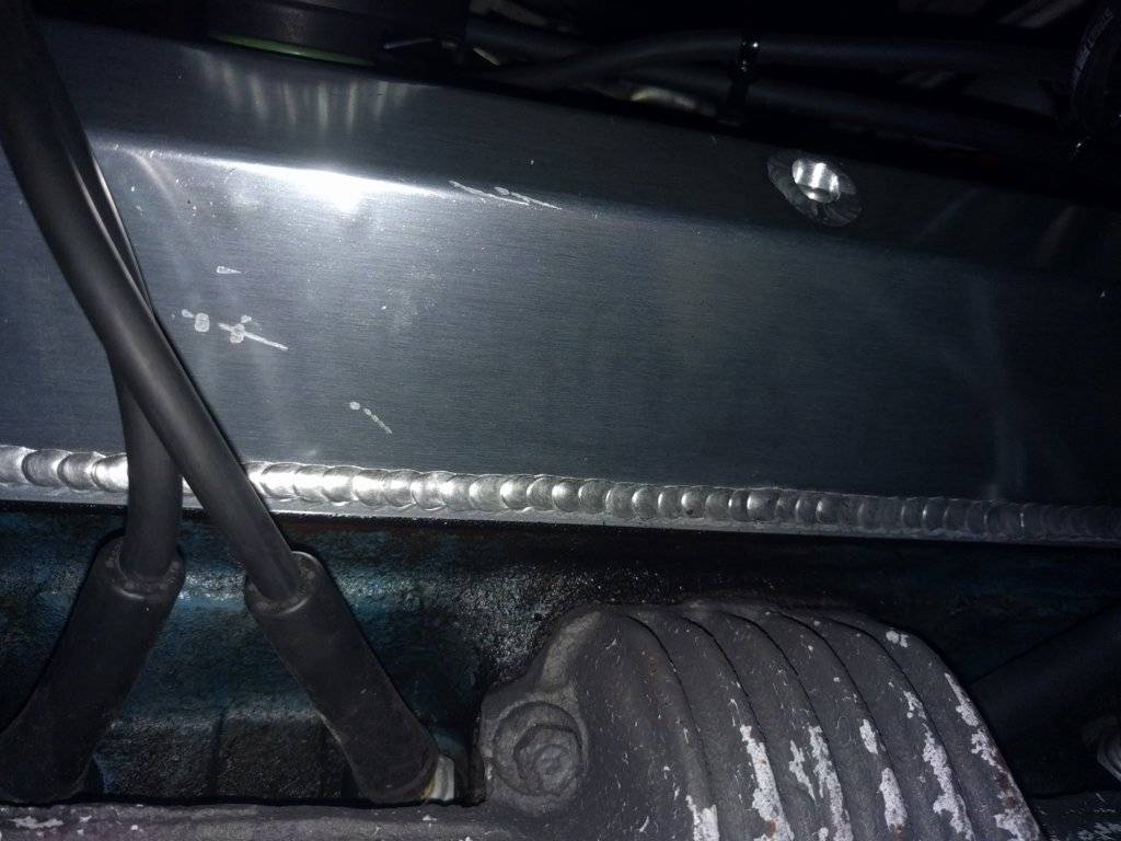

Last year I installed some fabricated valve covers on my Smallblock along with..i think they were edelbrock gaskets, they have only a couple hundered miles on them. I don't know if i haven't tightened them enough or what but they leak!!! It looks like the oil is seeping through the gasket, both sides the same.

Regardless of which gasket, use some red Permatex form a gasket on both sides to seal them. You may be having issues with the covers being slightly warped from all that welding and not making a good seat. The red stuff fills any gaps and provides a good seal. Be sure to have the mating surfaces free of oil.

see I only put some permatex on the covers and lightly glued the gaskets on. They seem to be seeping all the way around!?

If you're worried about the fabricated valve cover sealing surface, put a straight edge on the sealing surface and see what it looks like. Or put a thin skin of chassis grease on it and lay it against the cyl head to look for "hills and valleys"? But I suspect that's all in pretty good shape.
With any sheet metal valve cover, be sure to use a "spreader bar" with every hold-down bolt/nut. There were some good ones on the middle '80s Chevy small blocks. Rather than the smaller ones that are more like big flat washers, contoured to fit.
