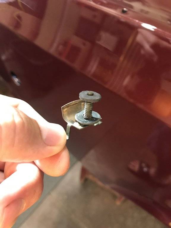

I am trying to find some sealing washers for my trim clips. It looks like a white mastic or crushable foam washer to prevent the clips from rattling against the paint. I cannot seem to find the right combination of search terms. I do not want to use silicone sealers. The studs are about 3/16” and the outside diameter is about 1/2”.

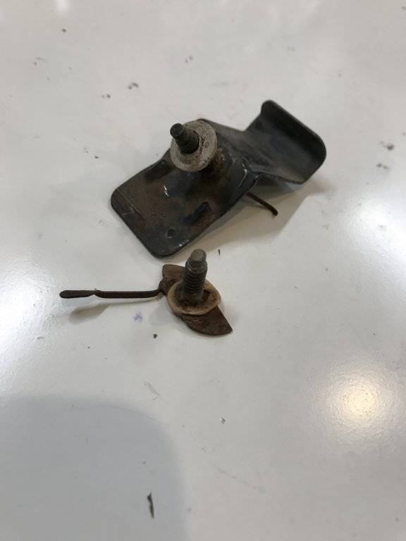

They compress to seal around the hole. They look similar to the foam used for mounting the accelerator pedal to the fire wall, but actually a little thicker. It is more like a white mastic rubber. It has hardened after 50 years but looks like it was very flexible and pliant when new.

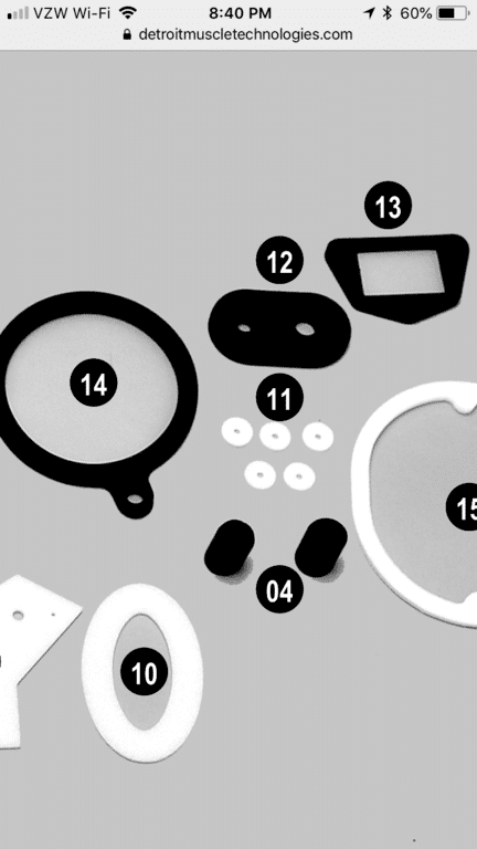

I could check with DMT. They have some larger foam sealing washers in some of their body kits. They use them to seal around the lights. I am not sure how good my washer cutting skills are. #11 in th picture may be a little large, but of course they are listed as N/A in their price list.

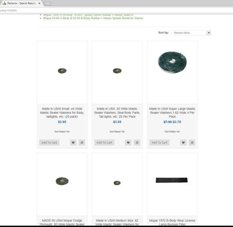

I found the site again if I don't have enough in my little bag. Partsmix.com

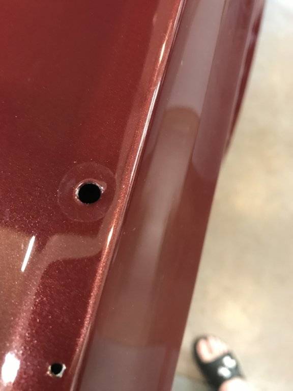

I think these mastic washers are the ticket. I tried the 1/2” one. It compressed nicely. It does expand out to about 5/8”. I might try the .44” ones. It may not expand in as big of diameter. The original were about 1/2 after compression.
It leaves a nice sealing pattern.

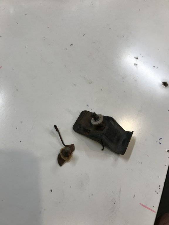

Original size before compression on top.
