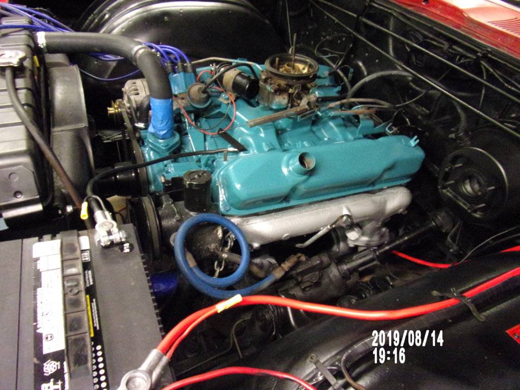

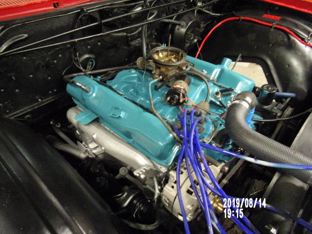

    Here are a couple of photos of the Newport's 383. Yes, the previous owner painted the engine bay black, so I just went with the theme. For the purists, I don't plan to take the car to Pebble Beach.
