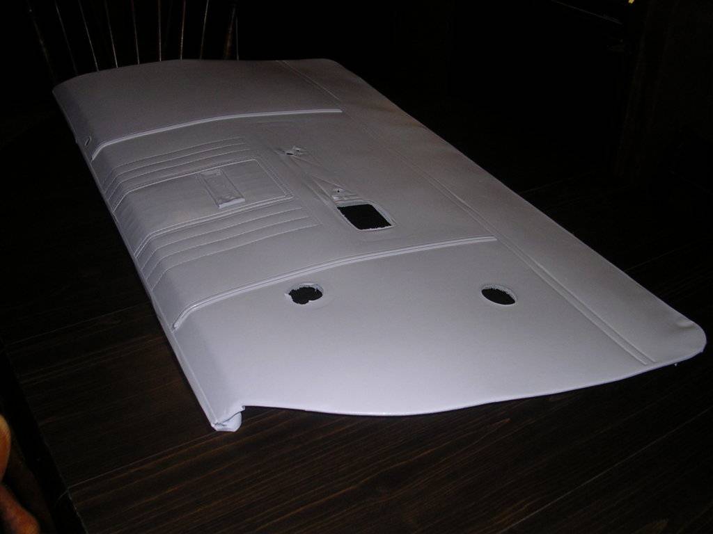

Here's a panel that a friend of mine dyed, though it was done in it's original color, so hiding a darker color wasn't an issue.

Wyatt, use the SEM paint first, then try other options if that doesn't work.
Wayne, I agree with SEM White Vinyl Paint. Formerly forest green Fury III door panel from my 1970 Fury Convertible Had to use a lot of thin coats. The stuff works if you're patient. BTW, your blue 71 Polara coupe is a cool car!
