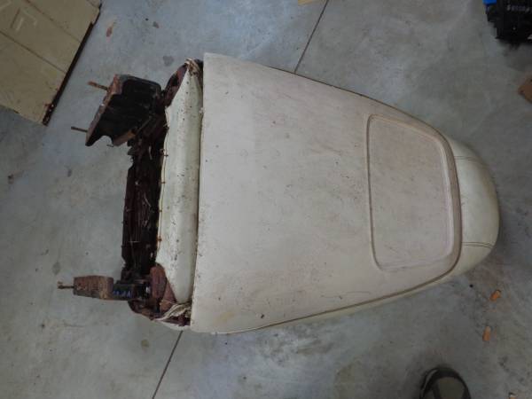

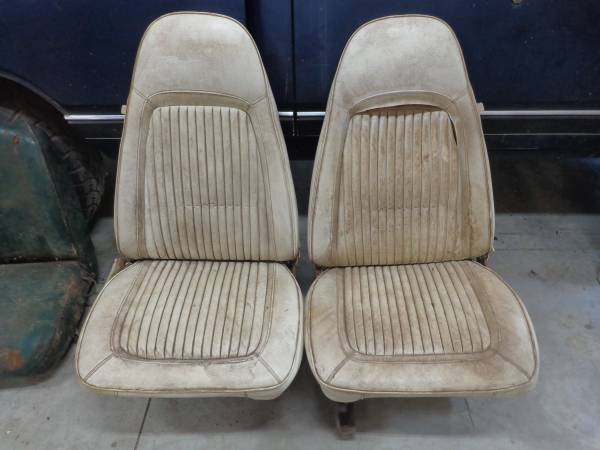

    I have a chance to buy these. Some say their BBody , some say Cbody.
    Seat tracks measure out same as Ebody. I've never seen fold latch at top of seat like that before. Can someone ID these. I had seller measure tracks their 16"W X13'L Same as in my Dart. 00O0O_eHPTgfiLPdh_600x450.jpg

    73 newport

    thanks I'll check it out. I'm looking to put them in a 70 Duster. I know Cbodies are not supposed to fit Abodies but tracks are same size as my Dart and if cushions aren't any wider or with in reason why not ? thoughts?

    With a quick look at Legendary and Classic Ind. catalogs I'm guessing "C" body Chrysler too.
    That vinyl pattern doesn't match any of the "A", "B" or "E" body seats.
