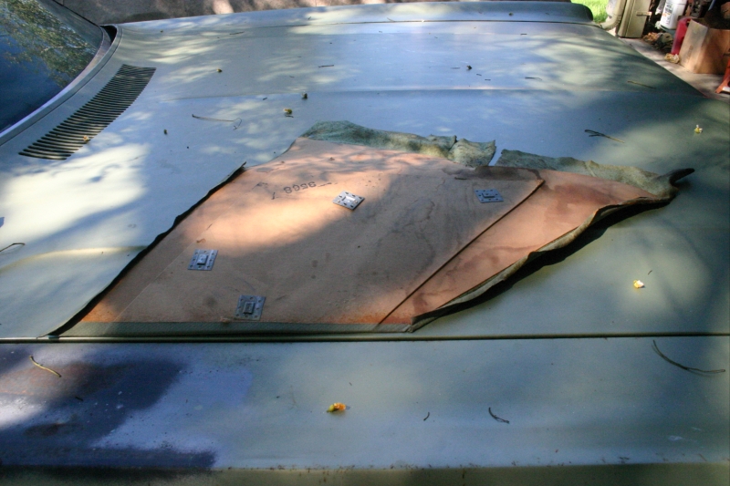

The sail panels on my CHP car were bad and probably came out in pieces and I do not recall what held them in.
I know there were clips bonded to the back side but do not recall where and how many along with the proper direction to move the panel to remove them.
I have another car with perfect panels and do not want to harm them removing them.
If it matters it is a 1969 Dodge Polara 4-door sedan.
Thanks,
Get a confirmation from a Fusie guy before you accept this as them...
Ok, that is what I thought, but I remembered the square pad they connect to more.
The problem is still where are they.
Well after first removing the seat, both of the end panels, the package tray I was finally to where I could remove them.
I ended up sliding a tire iron in till I felt something and popped them out. As expected one of the pads popped off but otherwise success (bottom center one in the picture).
