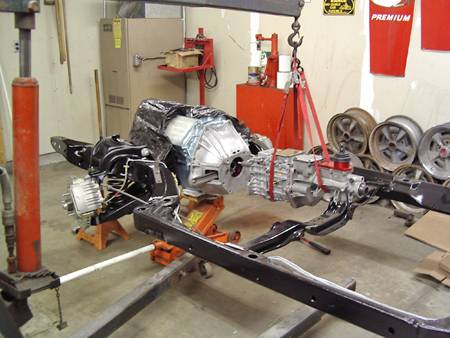

If it's not in the car, then lift the motor and trans as an assembly with your engine crane. The assembly of course will want to tip towards the extra weight of the trans, so get something to put under the trans to stabilize it that you can height-adjust periodically as you raise the crane to a good working height. It doesn't need to be anything major, but it will need to be strong enough to support the trans when it is separated from the motor, until you get it bolted to a trans stand. Another engine stand with a sling type of arrangement under the gearbox and tailshaft (two support points, NOT one), or a sturdy wooden cradle of 2 x 4 on some blocks. Have enough blocks around so you can build a platform not a tower and it will spread the weight of the trans out. If you build a tower to support the trans it will likely want topple once the weight shifts from separating the engine.
Here's a 3 point sling that will give you the idea that hangs from a single point - you could make this in 10 minutes - use another engine crane or a chain over a beam and rig it up with some sturdy rope.
