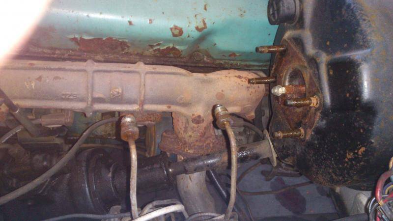

Pics when i remowed my MC, Polara -67.

Mike, I have the manual MC with no booster. thanks for the pic.

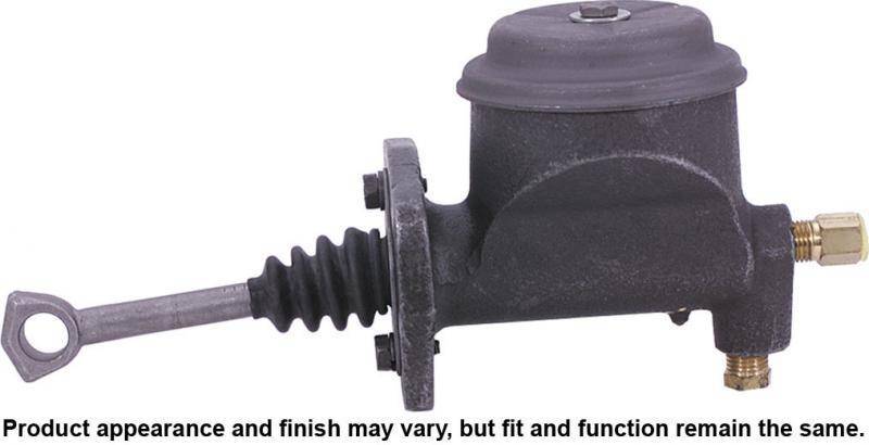

this is the exact style of MC I have, no booster.

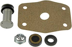

The rebuild kitbought off Ebay, I'm wondering if I ordered the wrong one.$(KGrHqV,!iEFD2gDJ8gIBRC1GBhkfQ~~_35.jpg

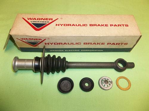

This is the push rod assembly. I am trying to remove the piston from the pushrod. like I said the FSM say not to remove the piston. I guess I should have bought this assembly...
Two ways that have worked for me.
1. Leave the master installed and jerk the pedal back
2. I've had better luck just splitting the piston in two, hacksaw and a chisel
