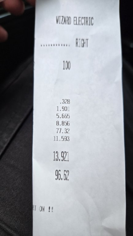

On the second pass it pulled a 1.9 60ft & broke into the 13s! Not bad for a very mild 440 with 3.23 gears.

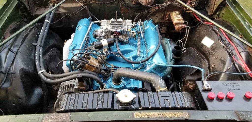

No AC, oem 22" rad & fixed fan blade. Engine was rebuilt with 6 pack pistons, sub 500 lift hydraulic flat tappet cam, oem valve train on otb Stealth heads. 800cfm avs2, hp manifolds.
Over Memorial weekend I threw in a used 340/383-4bbl factory high stall converter & an A&A 5400 shift governor. Those two things woke the car right up.

I had 3.91s in it up at Lebanon. What it really needs is more power to mph better.
There is more in it if it'll launch harder without spinning but it's only gonna et so fast with it trapping 96mph..
