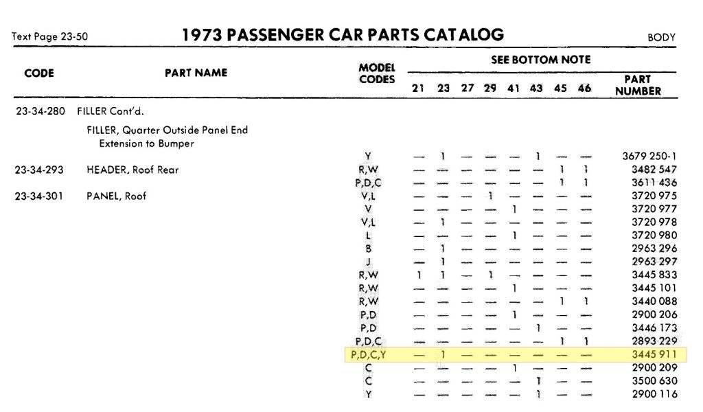

I'm looking for a roof skin for my 1973 Fury coupe. I'm wondering if any other models share the same roof. A 1973 Chrysler Newport coupe looks the same. I'm not sure though. Looking for options.
72/73 2drs should all share the same skin usually. There is a 72/3 plymouth 2dr roofline that is slightly different. I forget the model or trim off the top of my head.
The parts books have the answers.
1972 cars in the above chart will also interchange with your '73, but as Wyatt mentioned you have to be wary of the 1972 Formal coupes. They have a 29 designation in the VIN, and share a roof skin with the 4 door cars. The formal coupe body was dropped for 1973.
