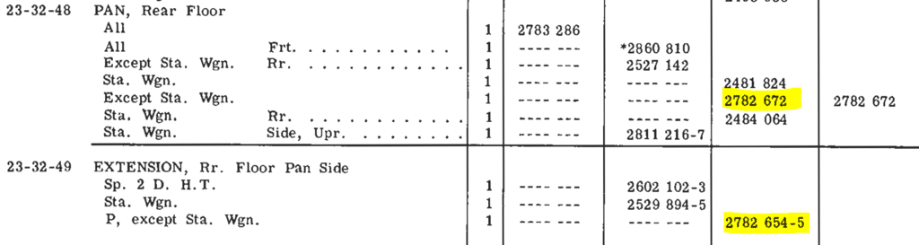

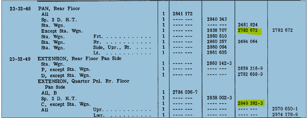

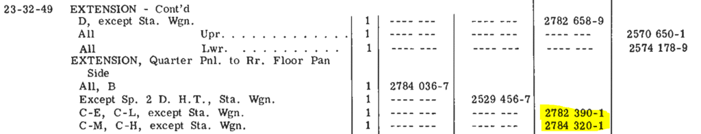

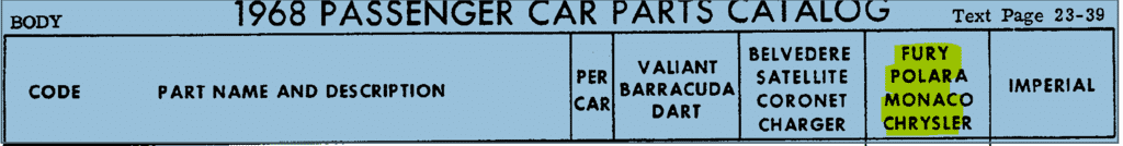

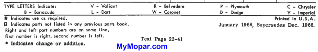

Based on the parts manuals it looks like the extensions for your car are 68 only but valid for any Chrysler. That doesn't mean that with some modifications, other 67 or 68 extensions couldn't be made to work.
From the 68 Parts Catalog
From the 67 Parts Catalog

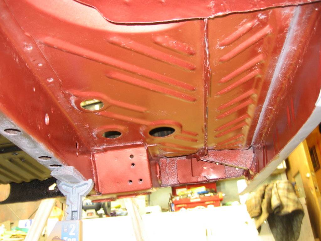

The trunk lid, extensions, trunk floor and lower quarter radii are the same on a 2dr or 4dr Newport for '68. The rear window channels do not interchange, nor does the rear sill.

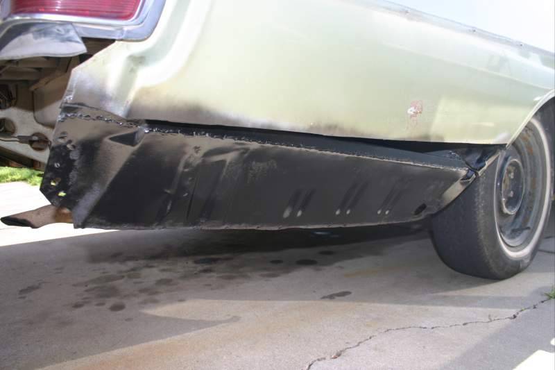

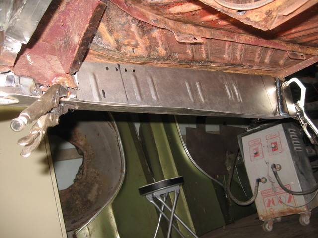

Unless you are looking for restoration perfect these can be made by putting the metal in a brake and bending, there isn't much to them.
This is the Other Polara I had, my first ever welding project. This was a salvaged piece but I could have made them if needed, there isn't really any shape to these unlike the outer piece.

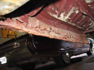

I am no expert. I had help too.
Basically copied from the old ones.
If I still had my shop I would fab a set.
But no place to work out of for now.
If you have nice used ones, use them.
