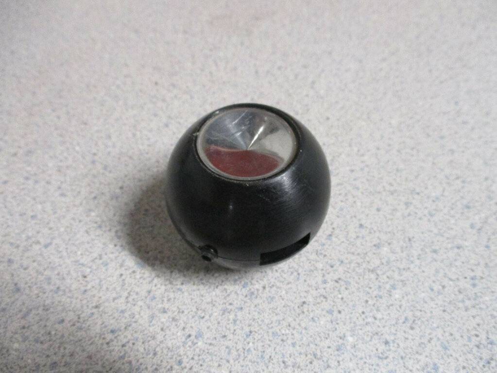

    what would you call this type of shift knob that has a rectangular slot and is held in place with a set screw?
    Trying to find an aftermarket one but they all are the threaded type or round with set screws and not for rectangular shift levers.

    I'd call it a 65 Mopar console shift knob. :poke: I know, not much help, but that's the only place I've seen one and never any aftermarket that I've heard of.

    FWIW . . . they were used in 64 as well. They also came in a variety of colors - I know I have seen a metallic red, metallic blue, and I think a non-metallic saddle tan. No one repro that I know of, you'll find them from time-to-time at shows and swap meets. The common problem is that the screw strips out. I'd assume that you could fill the hole in with epoxy, and then re-tap it - but never tried it. Will defer to someone who may have more experience in working with these materials . . .

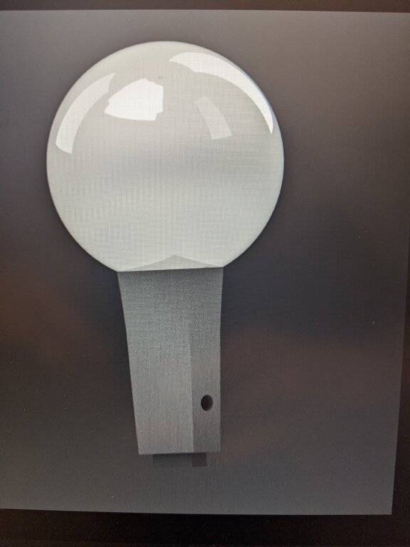

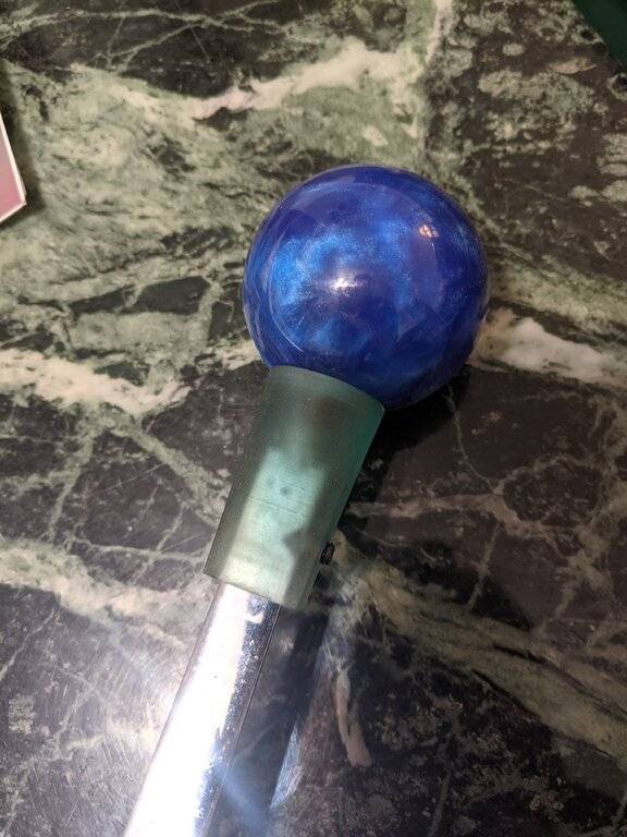

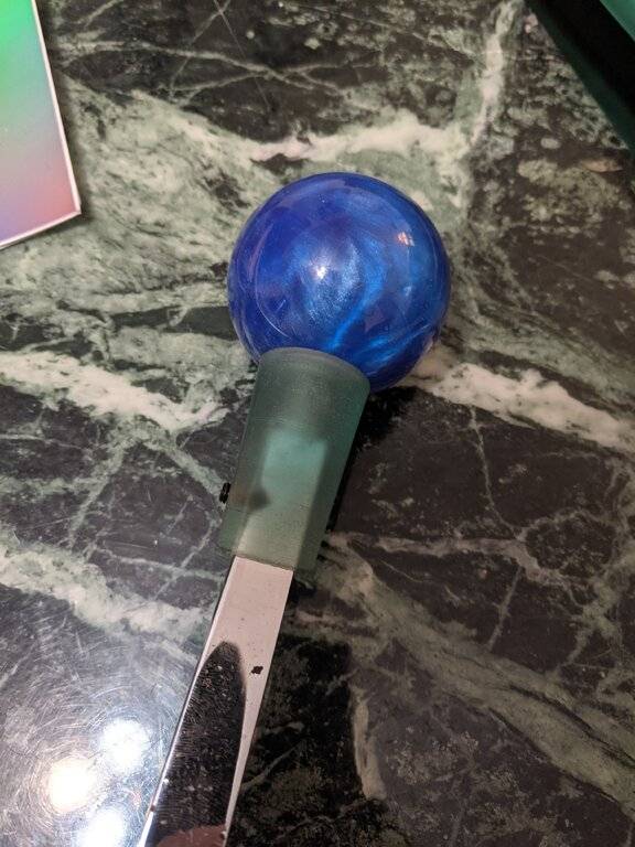

    Here's a few pics of the adapter I designed. I had a friend print it on his 3d printer. Fits perfectly, accepts any ball shift knob with an m8x1.25 thread. Needs to be painted yet, or not. I kind of like the raw translucent color of it.
