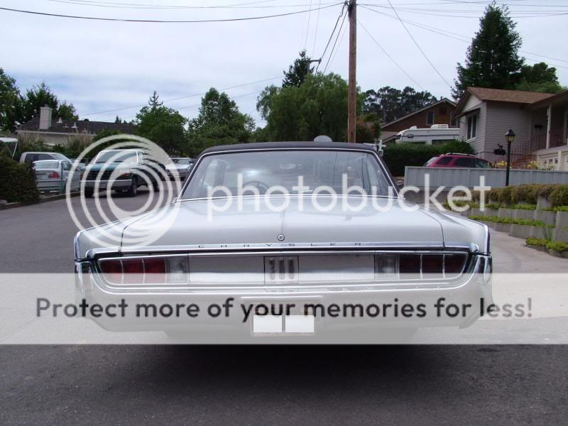

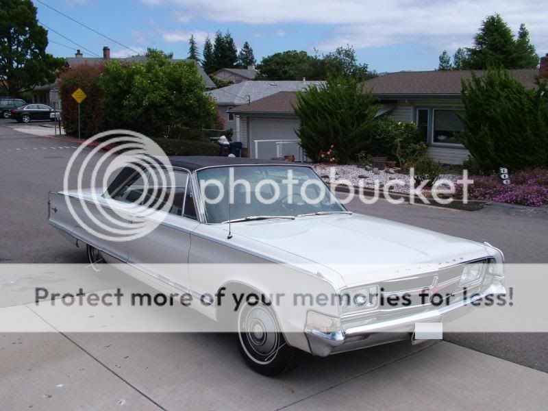

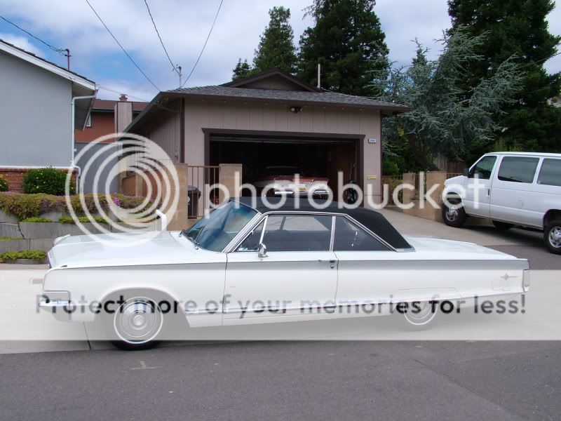

Well, here's my new boat...
It's a three owner California car and all original. The original owner bought it brand new in 1965, I have the business card of the salesman who sold her the car and other assorted paperwork to go along with it. The car supposedly sat for the past 15-20 years, the previous owner bought it and got it running then decided to sell for whatever reason. Car seems great to me, just gotta fix this transmission problem. No other issues whatsoever. Just needs a little TLC...
Sweet survivor; looks like a great starting point. I think I saw this car on eBay no too long ago? Where are you located?
Wow, curb feelers.:eusa_think: Haven't seen those in ........ forever.
Yeah, part of me wants to take those off but the other says leave em on...they've been there since the 60's. I remember seeing these on cars when I was a kid growing up in the Excelsior in SF....kinda nostalgic I guess..
