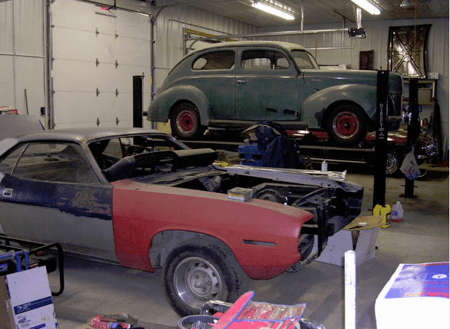

My shop is 40x40 I wish I would have gone 60 wide. I had to add a 20x40 lean to on the one side to park my cars under cover. Mine has 12' walls and 3 bays. One door is 11' high because I store my camper inside. The other two are 10x10. I also have a sliding door on the back side, for getting my mower out the back without dancing cars around.
I put a 2 post 10k lift in the center bay right in the middle of the shop. Works out great there for me, as can pick a car up and store one or two below for the winter.
I went with a 2 post vs. a 4 post because the ramps just take up so much floor space. I felt i would be tripping over them all the time, maybe if i had a 4 bay shop and put it on the end bay it would be ok, but that just wasn't an option and this works better for me.
I also put 2 foot of clear laminate along both sides under the eaves for light. Im so glad i did that. So bright that you barely need to turn the lights on when working in there except at night. I didn't want it to be like a cave in there.

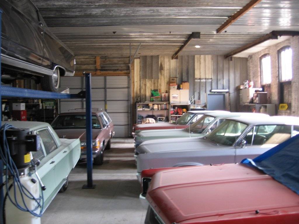

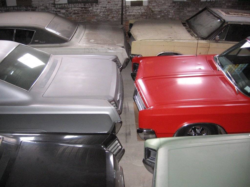

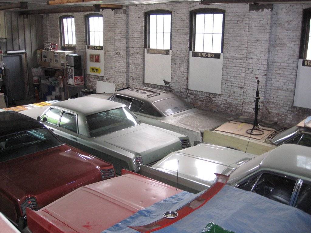

My shop is 50'x 50' with 15' ceiling.
In the 13 years that I've been collecting these cars, I've learned one thing:
No matter how big you make it, it will soon be too small.

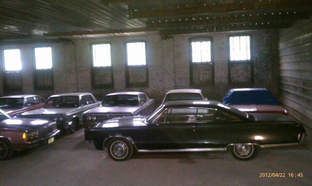

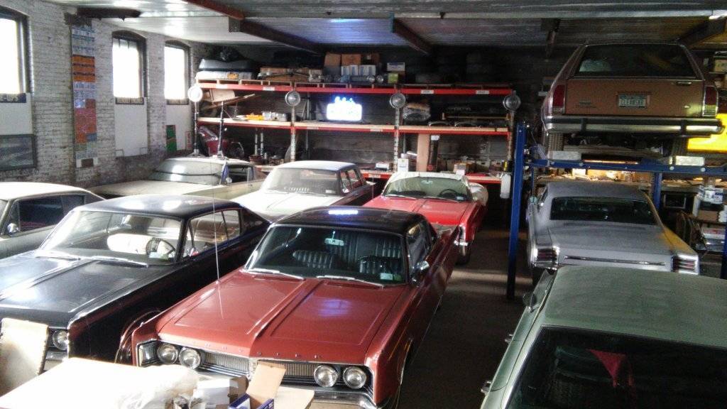

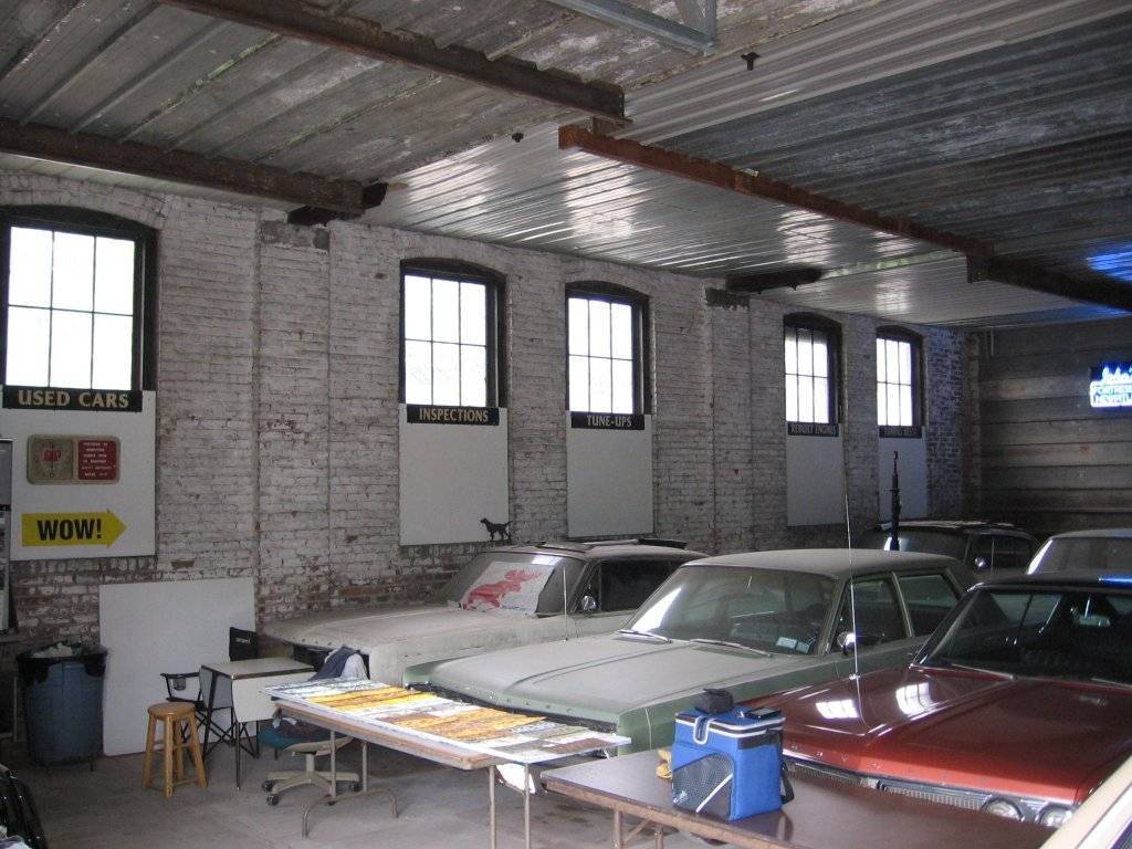

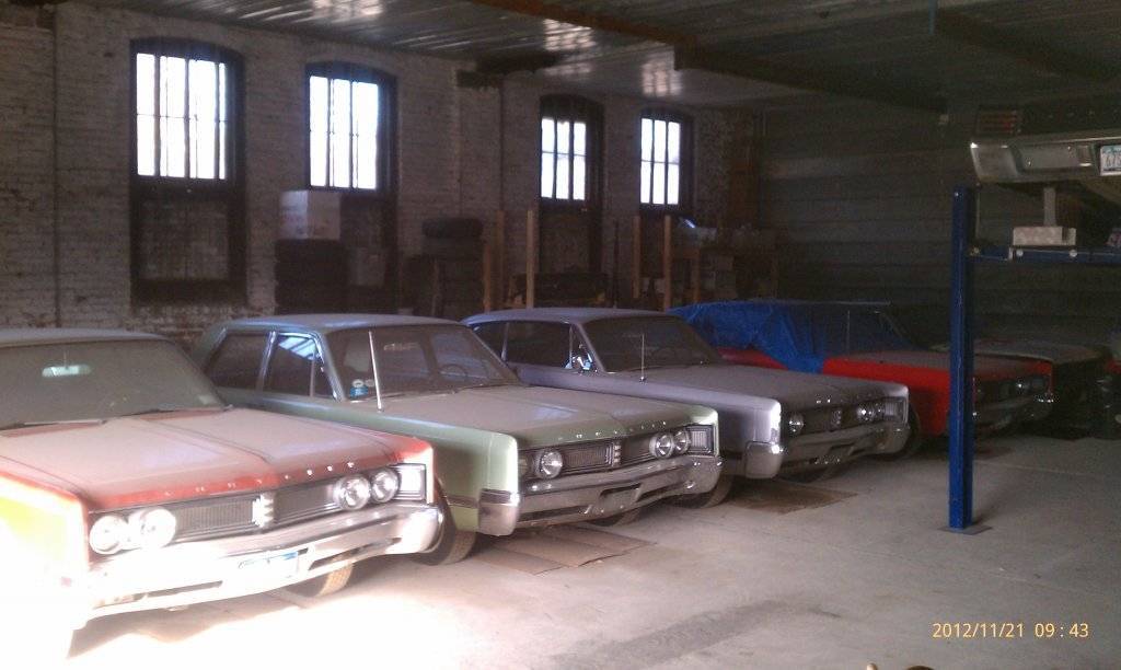

Here's some progress pics from when I moved in almost five years ago:
Turned the cars and fit 6 where 5 used to be:
Where we are today:
Cool pics:
Hope the input gives you some ideas.
John

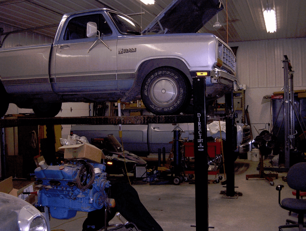

Mine's 30 x 60 with 3 bays along the long side and space for another bay with no overhead door there - deliberately done that way so I couldn't stuff so much in that there was no room to work on things and room for equipment or tools in the fourth spot. 14' ceilings so I could easily put a car or truck on the lift with the hood open and not hit the top. Works well for me, now just need more energy to work on the stuff in there........ :rolleyes: As others have said, I soon ran out of room. I'm in NW Minnesota and average heat bill is ~ 100/mo in the winter @ 63 degrees inside, (off peak electric floor heat).
