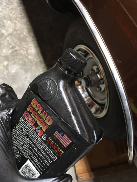

2) Air hoses and cords can be easily wiped clean with solvent like lacquer thinner on a rag. We have a couple of yellow goodyear hoses at work and over time they turn brown, some solvent on a rag and one to wipe dry, it's yellow again.

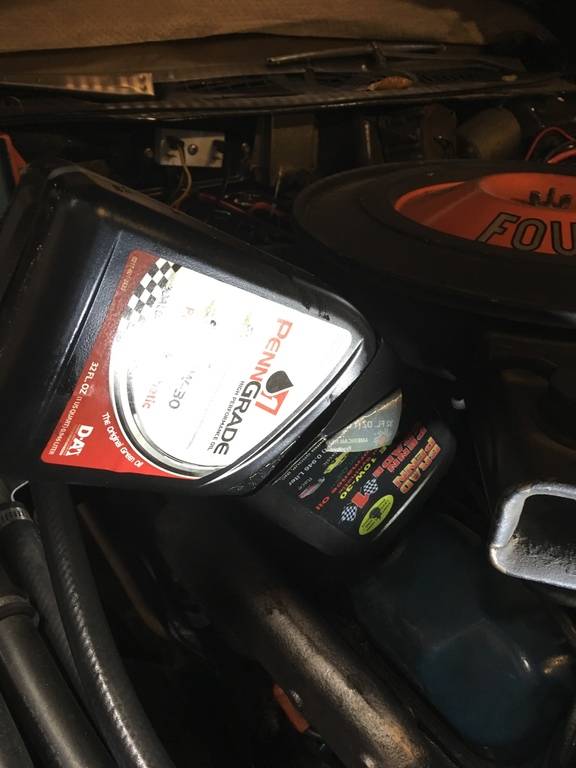

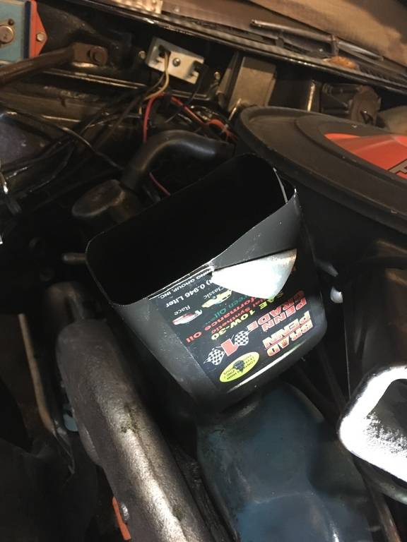

Since we don't have oil spouts to jam into a oil can, using the bottles of oil can get a little messy. I always end up dripping oil on the valve cover and onto the manifold. I'm also cheap...
So... I take a oil bottle and cut the bottom off and use it as a funnel.

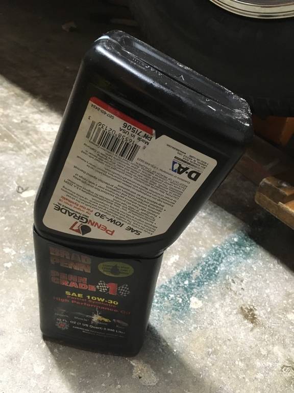

I also cut the top off another bottle. Being cheap, I hate to waste the oil left in the bottles after dumping them in the engine. There's always a little left, so I let the bottles drain into this cutoff bottle. Then I usually dump that in the engine... Or use it for filling my oil can.
Then I take the "funnel" and stuff it in the cutoff bottle and that's how it's all stored, keeping it clean for the next use.

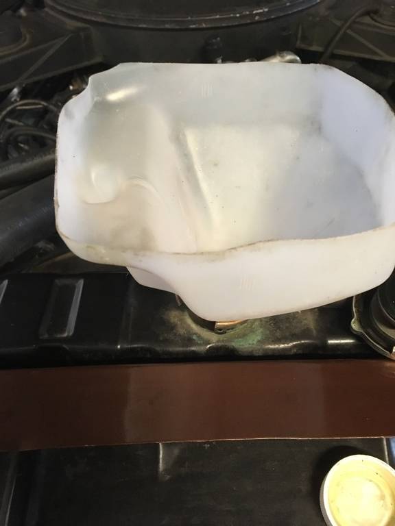

A cutoff windshield washer gallon jug is great for filling radiators too.

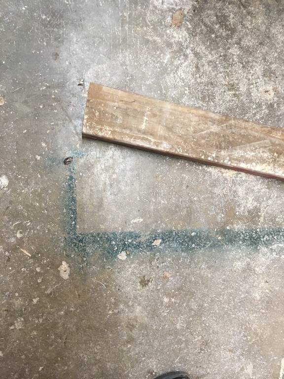

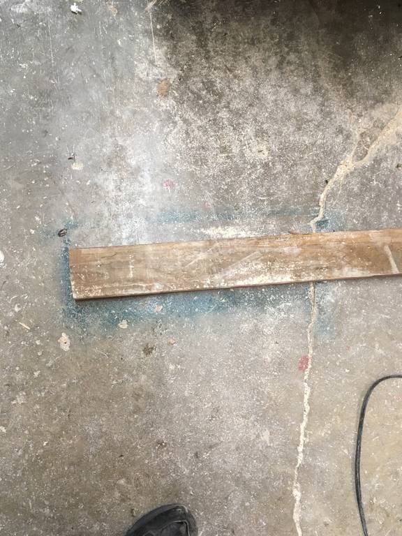

With the C-body so long, I want it to just fit into the garage... Enough to close the door and maximize the space in front. I tried stuff like tennis balls on strings and crap like that. I never liked things hanging when the car isn't in the garage, so that never worked. I painted a spot on the floor where I put a 2x4 and just toss it down and roll the car's tire up against it.

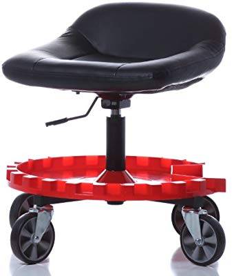

I have bought several carts over the years. This is by far the best one I have bought. 3 things make it better than others for me. Most comfortable seat, height adjustment, and storage tray.
It also works perfect with my 2 post lift. I have a low ceiling 10 feet, so I can't walk under the car. This cart is the perfect height. In fact even if I had a high ceiling I would probably most of the time keep it at a comfortable height for this cart.

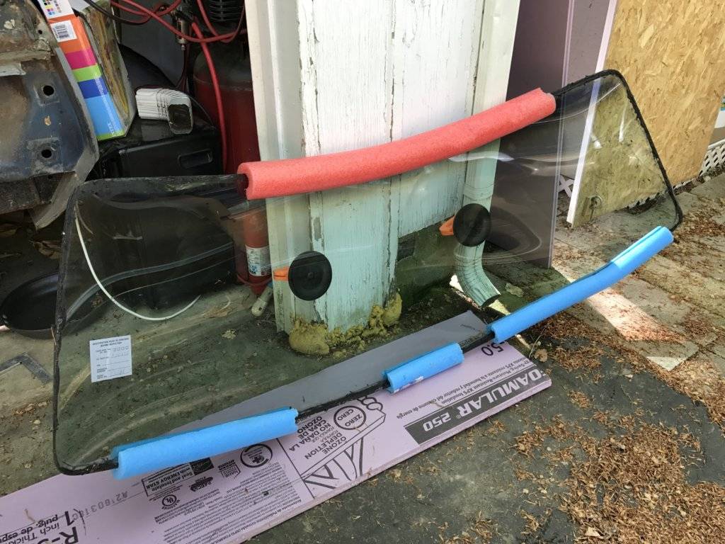

Another use for pool noodles. They make great protectors when storing or moving a windshield. I also use them on the ends of bumpers and fenders when they are off the car.

I've done one version or another of these, but I hadn't cut the washer fluid bottle off for filling the radiator though. The next one will get cut off.
