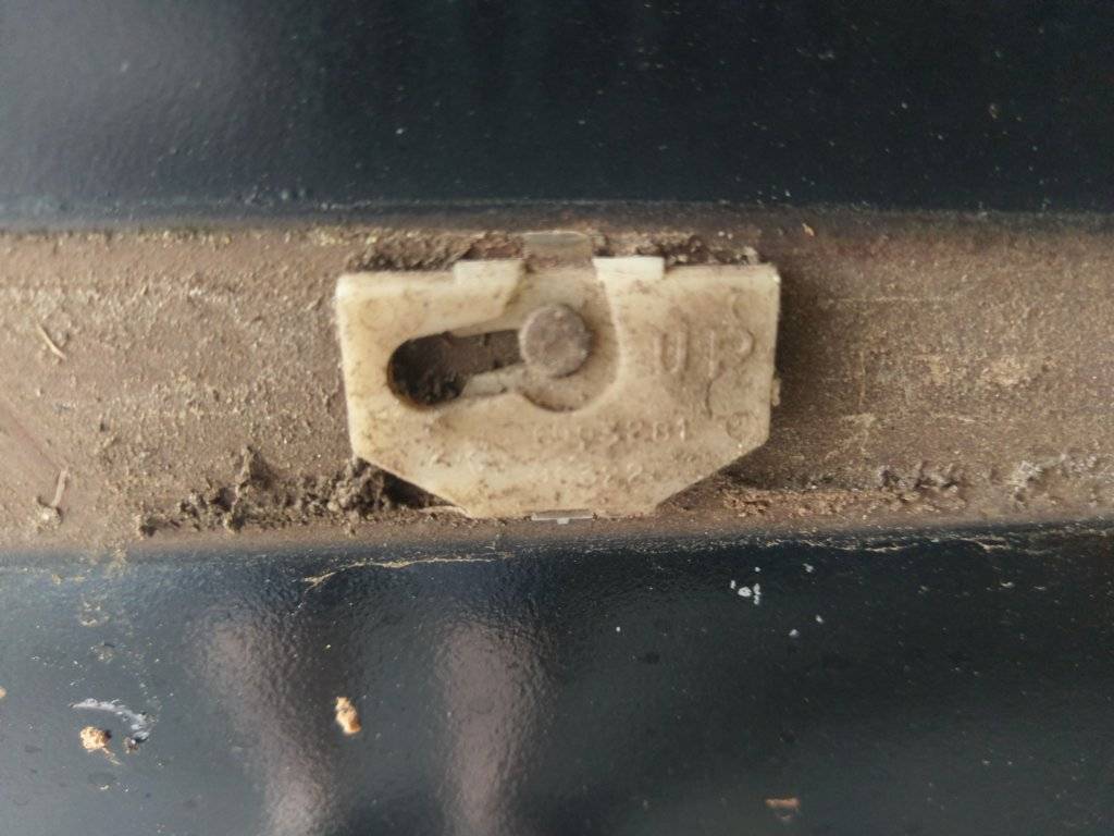

    How are they fastened on to the cars panels?

    With these. I am pondering whether to replace with new, but dont know where to start looking.

    Does anyone know a supplier for the end clips which bolt in at front and back? Mine are rusted out, so need replacing. Other option would be to attach pins to use same clips as shown (middle section had these doubled up, rather than bolt type and they worked just as good). Looks like they were spot welded at factory on surface, as do not appear to be all the way through the panel.
