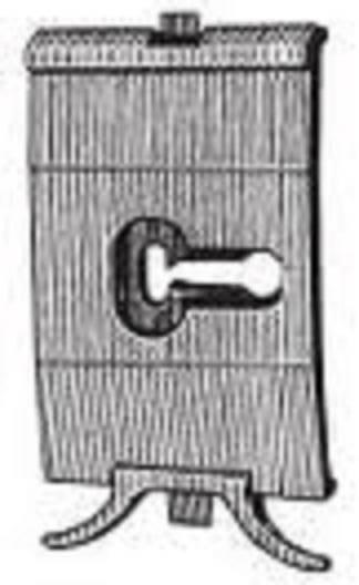

My '67 and '68 Chryslers have screws on the underside of the rocker panel, and once these are removed you bump the moulding upward gently so it unhooks from the clips holding the top edge.
If there are no attaching screws on the under side, you should be able to lift the moulding upward slightly against the spring end of the clip to unhook the top edge and pull it away from the vehicle just enough to clear the clips, then let the moulding drop down and off of the clips.
Thank Stan for the spring clip photo...
