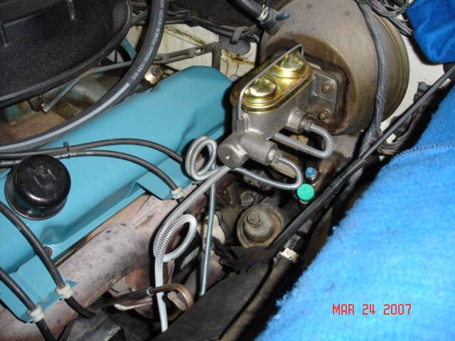

That is exactly what I did on my 64 years ago.

No distribution block , just plugged the rear line at the junction block and the ran the rear line up to the master cylinder. Been so long that I have done it , I would have to go retest the brakes . Have had a few panic stops and stops fine .
