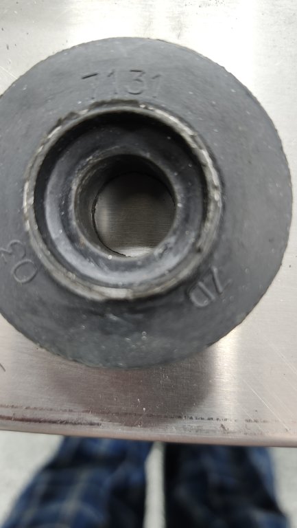

Does anyone here have any experience with strut rod bushings with no sleeves? I am restoring a 1966 300 and the strut rod bushings I got from Mobile Parts didn't come with sleeves. The directions refer to both with or without sleeves, but 3 of the rubbers are very sloppy on the bar and one is snug. The one that is snug has a different part number on it. Do the loose ones tighten up on the bar when you tighten them or do I have 3 rubbers that should have sleeves and 1 that shouldn't?

Maybe they made 2 versions of the bushing. You show #7130 and #7131 in you photo. Does one of them fit tight on the rod with no room for the sleeve? Maybe it's made that way, for use without the sleeve. So all 4 would need to be that type.
Yes, that is correct. They did make 2 versions, it's right in the directions. It appears that what I have won't work.
You said the Rock Auto bushings came with no sleeves. Would the old sleeves fit the Rock Auto bushings?
