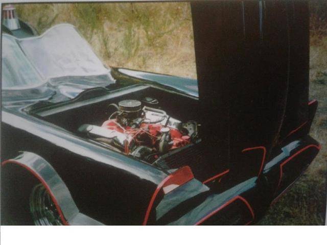

Ohh I got pics :) Late 50's Imperial..this once was. Had a 392 Hemi, but car was stripped of its drivetrain and I bought it for a couple hundred bucks so I and friends got a 440 out of a 69 Imperial and installed that about 1986 . All sheet steel over a 1/2" conduit framework. All gas welded together.

Ohh I got pics :) Late 50's Imperial..this once was. Had a 392 Hemi, but car was stripped of its drivetrain and I bought it for a couple hundred bucks so I and friends got a 440 out of a 69 Imperial and installed that about 1986 . All sheet steel over a 1/2" conduit framework. All gas welded together.View attachment 300436

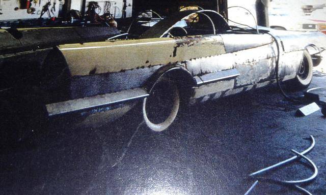

This is Carl Green's EMT framed Bat replica that was under construction in 86'....
This type of steel work still required a TON of bondo to smooth out....there still had to be a better way to make a bodyshell I thought..faster., I just hadnt learned it until later.

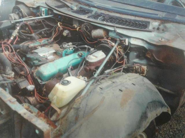

Had to shorten and flatten the firewall, kept the booster but put it behind the firewall

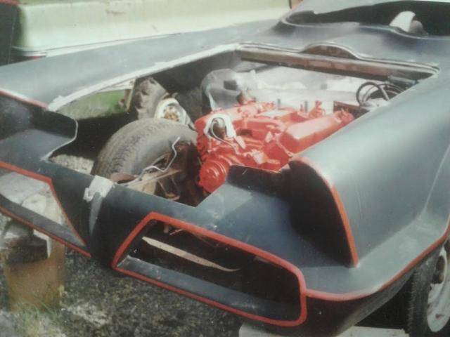

Got a fiberglass shell molded off the original tv car out of LA and remodded it to my own specs., placed it on the too short of a wheelbase floorpan for a trial fit, being a unibody there's no frame to stretch..so what do ya do? You move the leaf spring perch and the axle back 3". Simple. Pulled the 440, rebuilt it and of course..painted it Hemi orange.

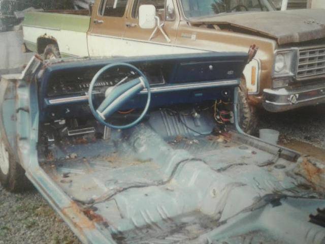

Loved that tile/tele steering column but not the column shift, so cut that off and got a floor shifter outta a 68, lengthened the rod and went from there.

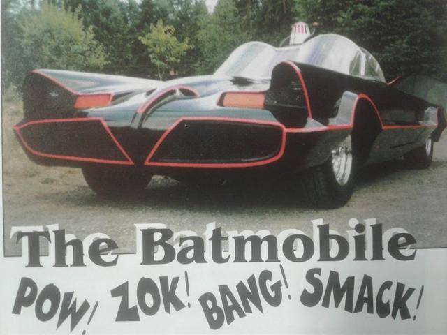

Fast forward to my finished 440 Bat, long and lean. The icing on the cake was when it was featured in Chrysler Power magazine. made my year!
