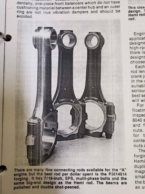

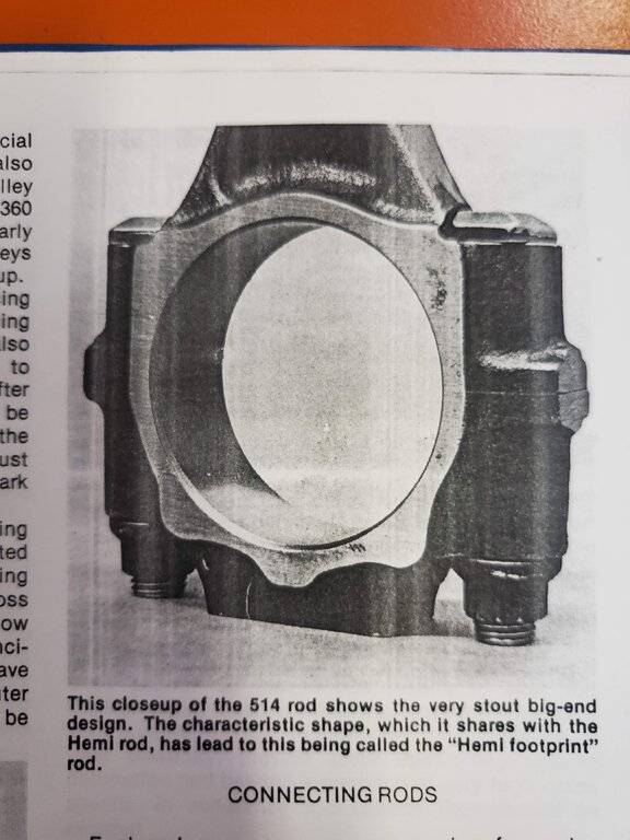

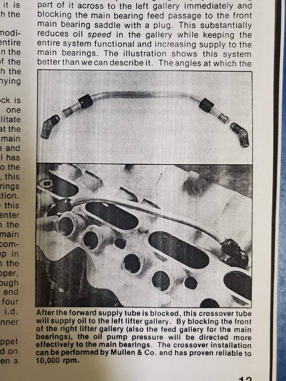

Thanks for input. I don't think think they were trying to fix anything. He had the motor custom rebuilt. Forged crank ect..

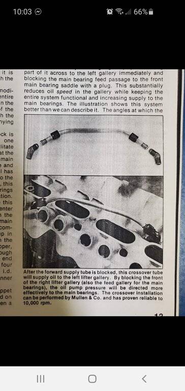

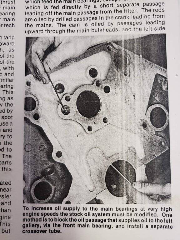

I've been told it doesn't really help or hurt and I'm not racing the car. I want a car I can drive an hour to a show or 2 and around town. He sent me pages from an old manual to better explain.
Thanks for sharing that information, I have never seen that set up. Looks like a high rpm race modification. Will it like loafing around 3000 rpm all the time? I can't say one way or the other. Could be no problem at all, but, as CBODY67 says -
will you be using the engine in that mode?
Also, given that it was built as a "race" engine there could have been other mods made, that may have made it a fuel hog.
There is NO problem with putting more oil to the mains, first. There is a way to restrict portions of the B/RB oiling system to do that, BUT consider why Chrysler would put more oil to the lifters, first, rather than the mains. And to possibly bias the oil system of the LA motor somewhat similarly.
The basic design of the B/RB engine is quite similar to that of the Chevy small block of 1955. The performance orientation of the Chevy small block (their only V-8 at the time) was to put oil to the mains first, then feed it to the hydraulic lifters.
Chrysler, on the other hand, chose to bias the oil flow to the hydraulic lifters first, then the mains. WHY? Consider the intended customer base for Chryslers (per se) being usually older and possibly with some hearing sensitivity decreases. They'd know that a ticking valve lifter would mean their engine was low on oil. So they'd stop in at the local filling/service/gas station and get the "young man" to check their engine oil level.

This oil system mod was mostly used on race engines turning 6k+ rpms. It won't hurt anything at lower engine speeds. The question I would as is how much this engine was run at high rpms and how much is left of it. The steel crank and the heavier rods add to the low end strength as long as the engine was properly rebalanced after the mods were made. Adding heavier rods increases the low end mass so there is more strain on the rod and main bearings. That is why more oil is put to the lower end on racing engines. If this engine was built primarily as a race engine, it probably will have a relatively short life expectancy on the street, these engines are built to go very fast at the expense of longevity. Check the cam specs, if the usable torque range is above 3500 rpms, it is not really suitable for a street engine that is going to be a day to day driver. Will eat lots of fuel and be miserable to drive in traffic.
