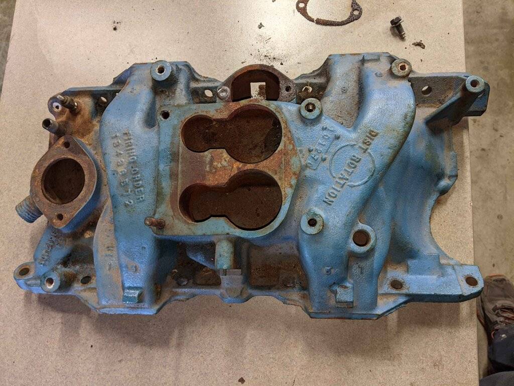

I purchased the intake below from C-Body Bob.
1971 Model Year 3512100. (Yes, it will go to a machine shop for clean up. No, I do not care that it weighs 47 lbs. My car is heavy anyway and I have no intention of racing it.)
  • I would like to use the choke heater block off and an electric choke
  • I would like to not use an adapter plate, because I don't want to raise the height of the carburetor. (this manifold puts my carb .25 inch higher than current 2BBL mounting height
  • Edelbrock does not seem to produce a new spread bore carb
  • Holley does. Has anyone used an electric choke spread bore Holley that they would recommend?
  • I saw the 1900/1901 Demons. Would like to know if they bolt up without issues and without much increase in height?
  • Your advice and suggestions are appreciated. Thanks, Ben

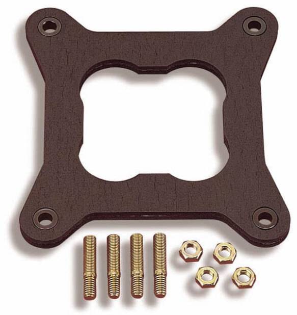

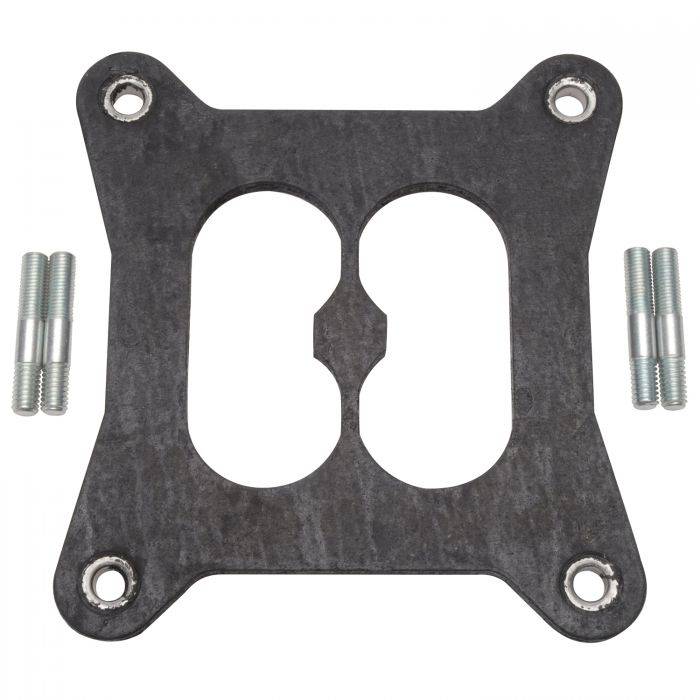

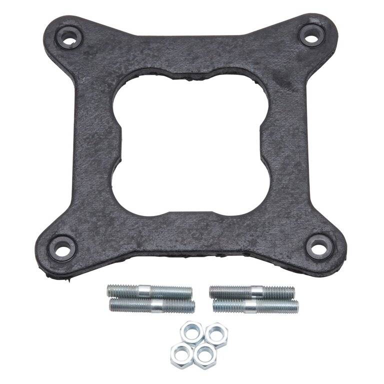

Holley only shows the spreadbore thick base gasket. Edelbrock has several square-bore gaskets (attached). The one with the divider is what was on my 1970 Monaco 383 N when I got it. There are also some Chevy Truck Holley 4bbl thick base gaskets with 4 equal holes in them, too. Might need to get into the Edelbrock online catalog to see what the differences are between the 9265 and 12410. Not sure why the only one they currently show in stock is the 12410? Top = 9266 #2 = 9265 Bottom = 12410
I suspect the base gasket for the Street Demon, considering its secondary throttle plate, might be similar to the old Holley 3bbl base gasket?
CBODY67
IF you are near a NAPA store, you might swing by and look in their carb base gasket listings by application or an illustrated listing. Key thing is that they are the thick, OEM-style gaskets (as pictured, but probably without the carb studs and nuts) and not the "thin and soft" gaskets! Personally, I like the "black" hardened studs and then use the normal nuts rather than using the softer steel studs, which have been known to twist off.
CBODY67

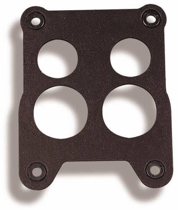

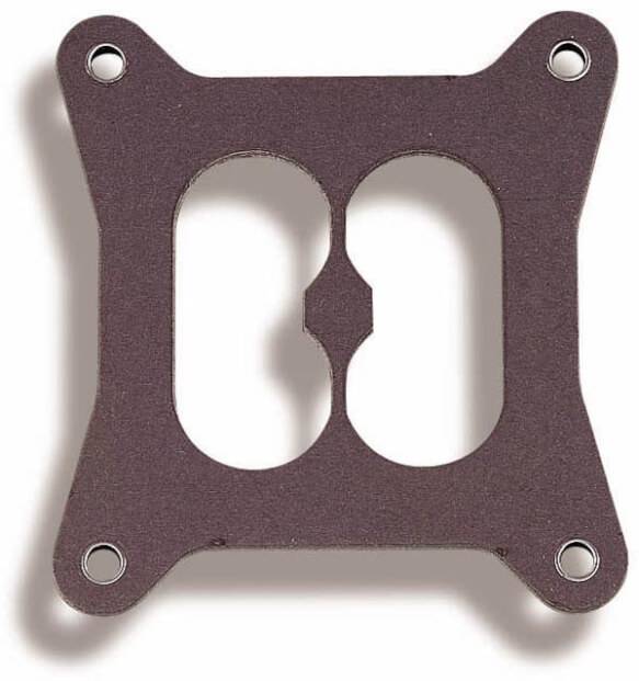

Holley equivalents. Holley sells some under the "Quick Fuel Technologies" that appear to be the same as their normal Holley items.
Top = 108-12 #2 = 108-18 #3 = 108-25 #4 = 8-812 QFT

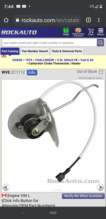

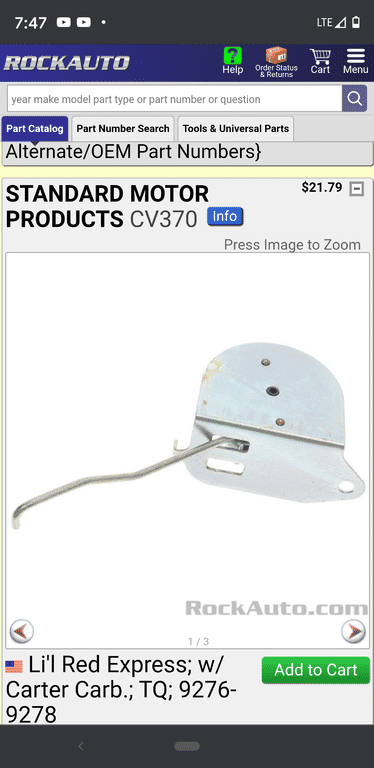

If that is not good you could make a bracket to hold a 73 up choke that has a heating element in it it was to have the choke warm faster.
Like this unit
Of course it's out of stock.
They have one for a Lil red with a
Dammit it does not have the heater.
They have other ones but you have to modify.
I BELIEVE THE 71 HEATING ELEMENT IS DIFFERENT, SHORTER FRONT TO BACK, BUT I APPRECIATE THAT THE PRINCIPLE IS THE SAME. MAYBE THE BRACKET AND SOME BENDING WOULD WORK. EITHER THAT OR I NEED TO BUY A 71 HEATING ELEMENT.

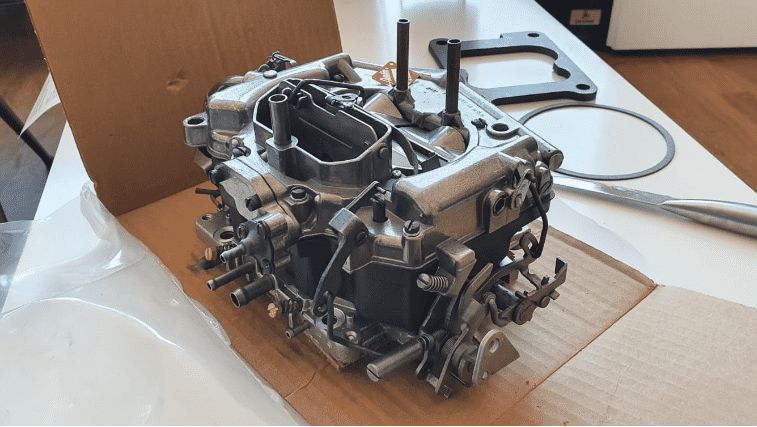

I'm picking my TQ up from Dave today @ Woodruff's.
I'll have it on in next day or 2 and let you know. I'm sure it will work excellent. I'm not running any choke, just another theft deterrent.
