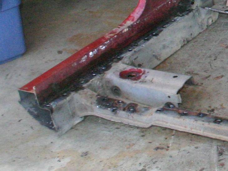

I'm not sure what your plan was or the condition of your rockers but I would take the time to cut away the rockers on these and install them like the factory.
I'd just take a 1/2" drill and drill right through the spot welds on the replacement parts, this will give you a nice place to plug weld when you put them back on.
Removing the old ones is a little more tricky, I'd just cut as much away as I could and grind down the spot welds, you are not trying to save anything here.
Alan
Hi Alan.
That is good advice.
The rockers are in real good condition consider ing the connectors were not.
I had cut the old ones away and prepped the rockers ahead of time.
I will do just as you suggest about removing the extra metal ftom the one's you sent me.
Now I can work on getting the stub frame back into the car.
Thanks again!
