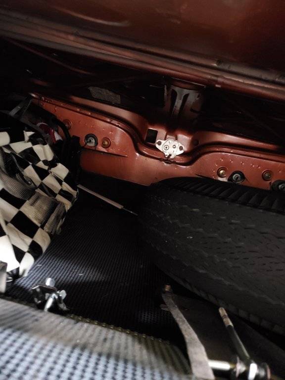

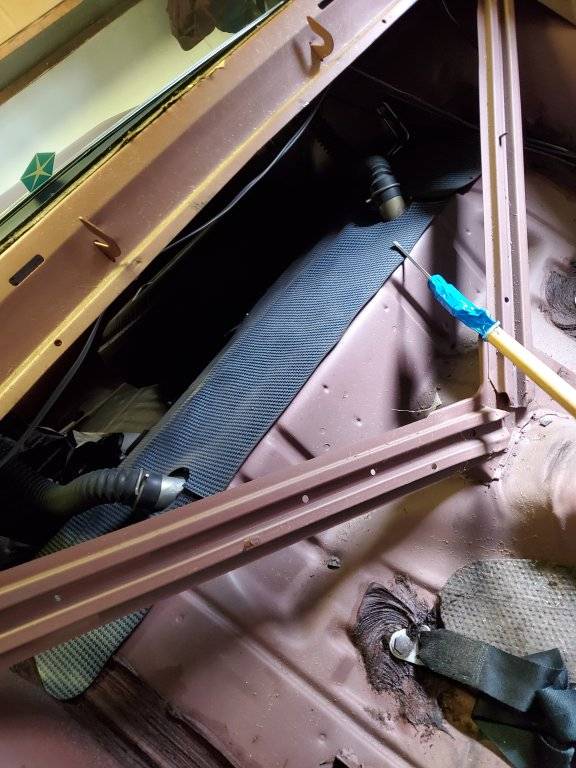

I've got a similar situation on a few of my cars. The key turns, against resistance, and then returns to the original position, but nothing happens. And the lid will not "flex" up with the key turned. In an earlier thread, there was mention of "installing" a blade screwdriver end into a long broomstick to actuate the latch from the inside. There is a slot in the latch, on the inside, which can be indexed with the screwdriver end, but it'll taks a long broomstick once the rear seat is removed.

Now time to go inside the trunk and unbolt the latch

My lock cylinder went bad and I used what cbody 67 described with the broom handle and screwdriver. But having a convertible, I was able to get to it through the convertible top well. In a coupe or sedan, you will have to remove the bottom and back seat cushion to get into the trunk. Not difficult, just a little time consuming. Once you turn the slot the trunk should pop open, then you can replace the lock cylinder.

Send them in throught the back seat with either a 1/2 inch or 13mm wrench or socket, lefty loosy!

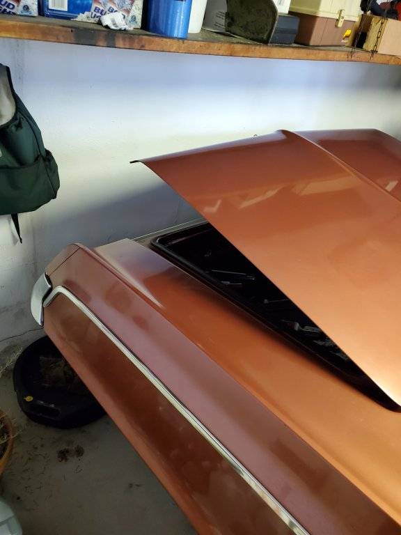

Success with the broom handled screwdriver!

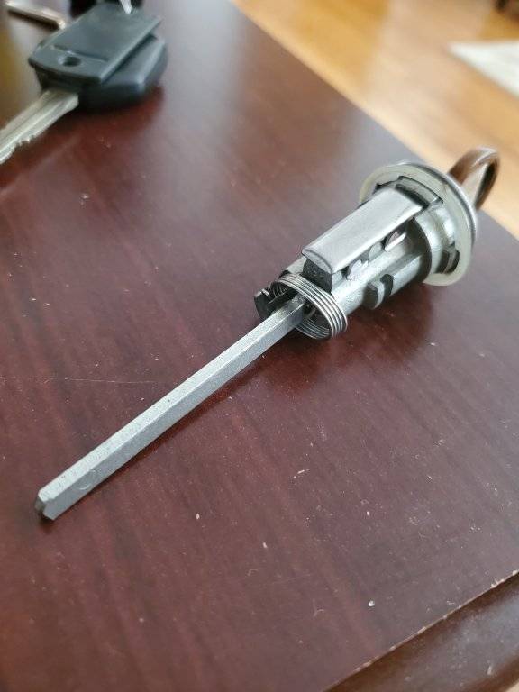

Now to see what's up with this lock cylinder not engaging...
Congrats!! Glad it worked!! An empty trunk and no spare tire?? WOW
All fixed.... the little coil spring on the cylinder had popped off, so the end of the rod wasn't turning. Replaced everything and tested the latch like 50 times... good to go. Thanks all
