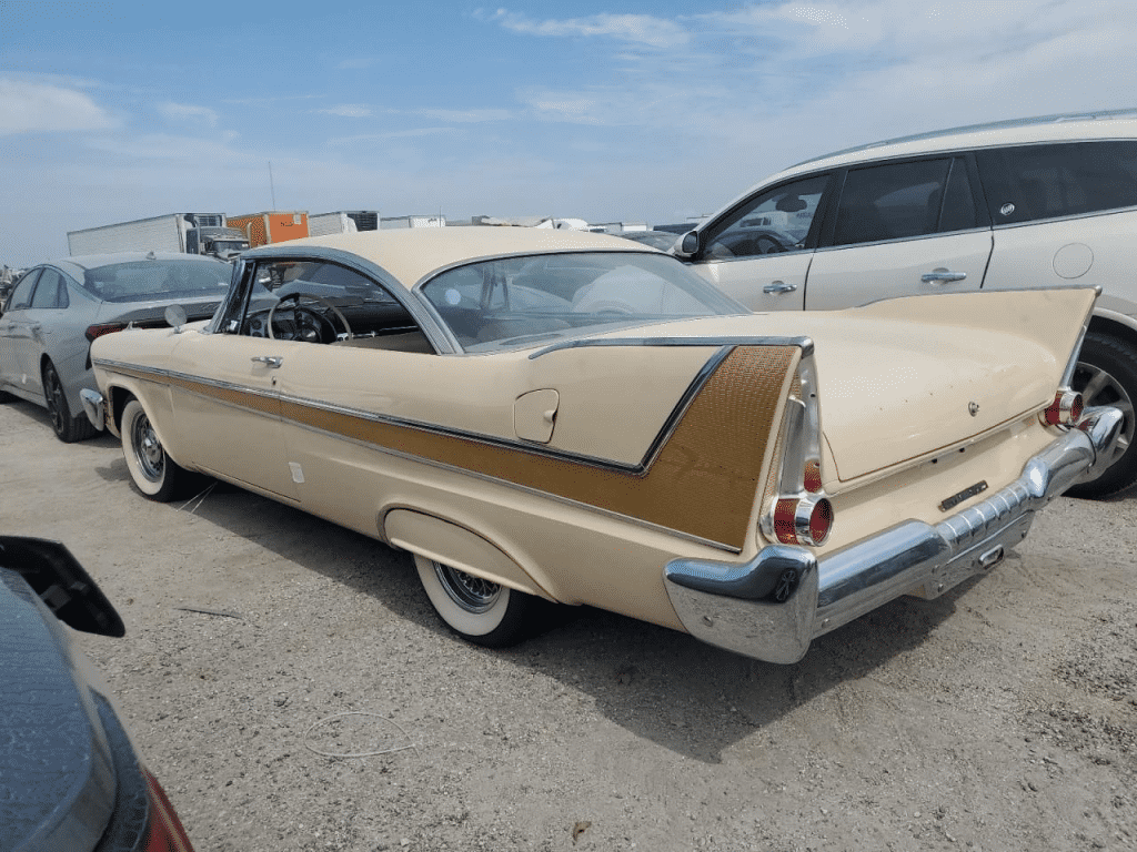

Came across this on a salvage reseller site. Obviously a write-off from recent hurricanes.
The “bad” thing about this site is the registration process requires you to put down a deposit as a condition of bidding. Also, there are a lot of fees, which can add up.
At least the site is transparent enough to provide a calculator so you can “what if” your bid(s) in order to get an idea of your final price.
Hope this helps finding it a new home or keep from being eventually parted out.
1958 Plymouth Fury For Sale in Riverview, FL Lot #75903***
What am I missing? Why would a car like that have been written-off? It doesn't look damaged at all...

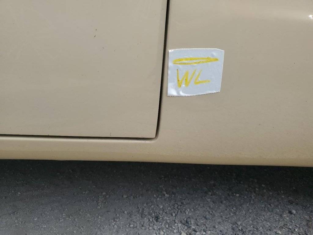

Water/flood damage, note the pic with the water line. Flood damage can be very difficult to detect and fix.
Oh! Is that what "WL" means! Yikes, that sucks... still, a disassembly, thorough dry-out and clean-up and it can hopefully be saved!

If that yellow sticky represents water level reached, perhaps most of the electrical/dash was spared. Carpet, seats, interior panels may be toast, though pictures look encouraging. Darn thing had 6+ inches of water in it .. old car, new car -- that concerns me.
TO ME, that would suggest its a least a parts car, or better yet it could be/in fact was rehabbed/made roadworthy at reasonable cost/success possibility.

The rugs, seats, wheels, etc. all look spectacular; would someone have cleaned it up this well just for a flood auction? Getting beige vinyl that clean after flooding wouldn't have been easy...
Note the dirty/rusty seat hinge cover. Now imagine what those harder to get to spots will look like. Tampa area got hit with a record hurricane this past year, so salt water/sewerage damage could be the issue. Check the car out, if it smells like Fabreeze, run away....
Yeah, that bit of rust was the only thing I saw that looked odd. A professional restorer could probably tear the car down, clean-up/repair/replace what ails it, and sell it for a pretty good profit. Definitely not in my wheelhouse, but I admire those who can do so!

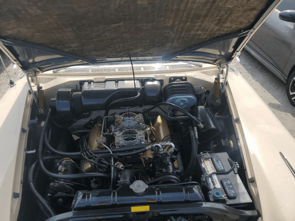

The wiring that is below the water line if correct, would be the power window wiring, breaker, maybe window motors, and the wiring towards the trunk so that's really no big deal. Need better photos of the door panels, if they are original they'd be moisture sponges. This is sad to see but I do hope it gets saved.. 350 Golden Commando equipped, add-on a/c, some electric goodies, and it's mostly complete. This sucks!

At the least, probably would need new seat foam, door cards, carpet; transmission and diff gone through, fuel system cleaned out. With any luck, the engine didn't get wet internally, unless water came in through the exhaust.
The electrical problems should be minimal, compared to a modern car.
The pic posted of the paper where the water line was shows the 1/4 panel, rocker, and door. There originally is a seam there so this car has been restored at some point.
