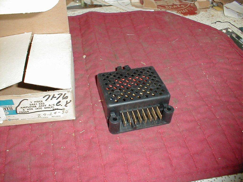

Yes the Formals had AutoTemp II 2.0 as it were. The fuselage underhood servo watervalve combo thing did not work out well because Mopar cheaped out on the materials which quickly led to leaky non functioning systems.
The 2.0 version of Auto Temp II that was in the Formals sought to remedy those issues, which I think it did. In my experience with Formals, 99% of the system function problems I ran into were solved by replacing this box (called the "amplifier"):
By problems, I mean air not flowing to the proper vents when different modes are selected. If you have no charge in the system, it must be addressed in the same way as any A/C system.
