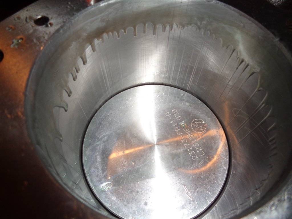

something is scratching cylinder 8
Cartel
Jan 13, 2023
324
96
Chilliwack BC

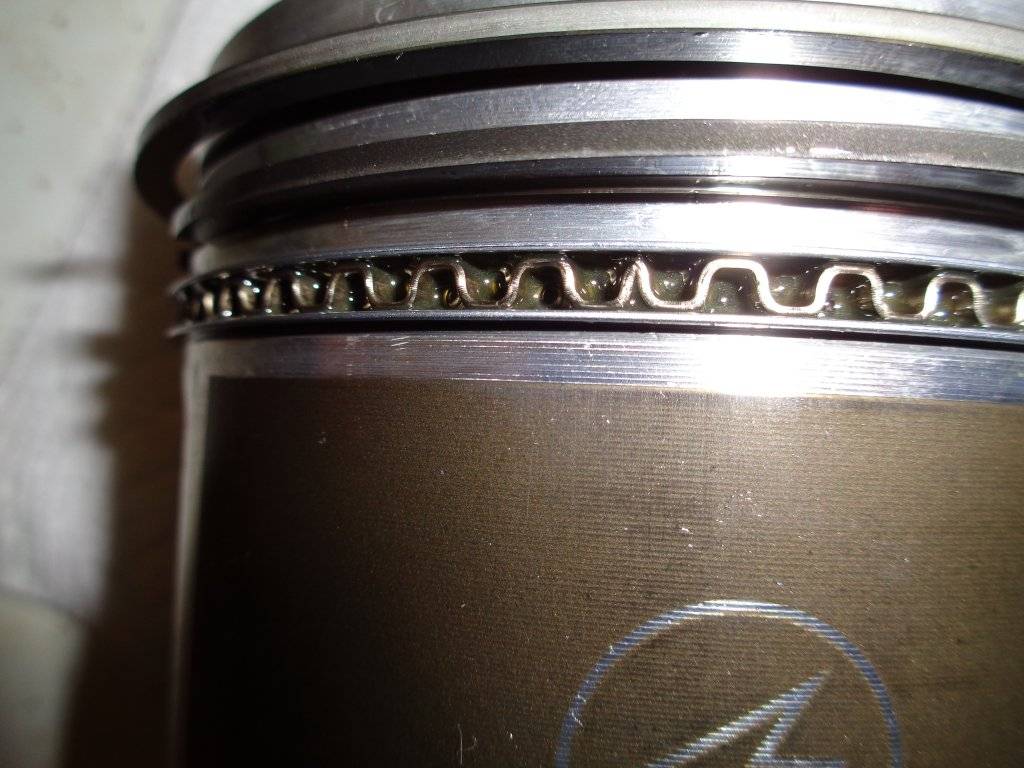

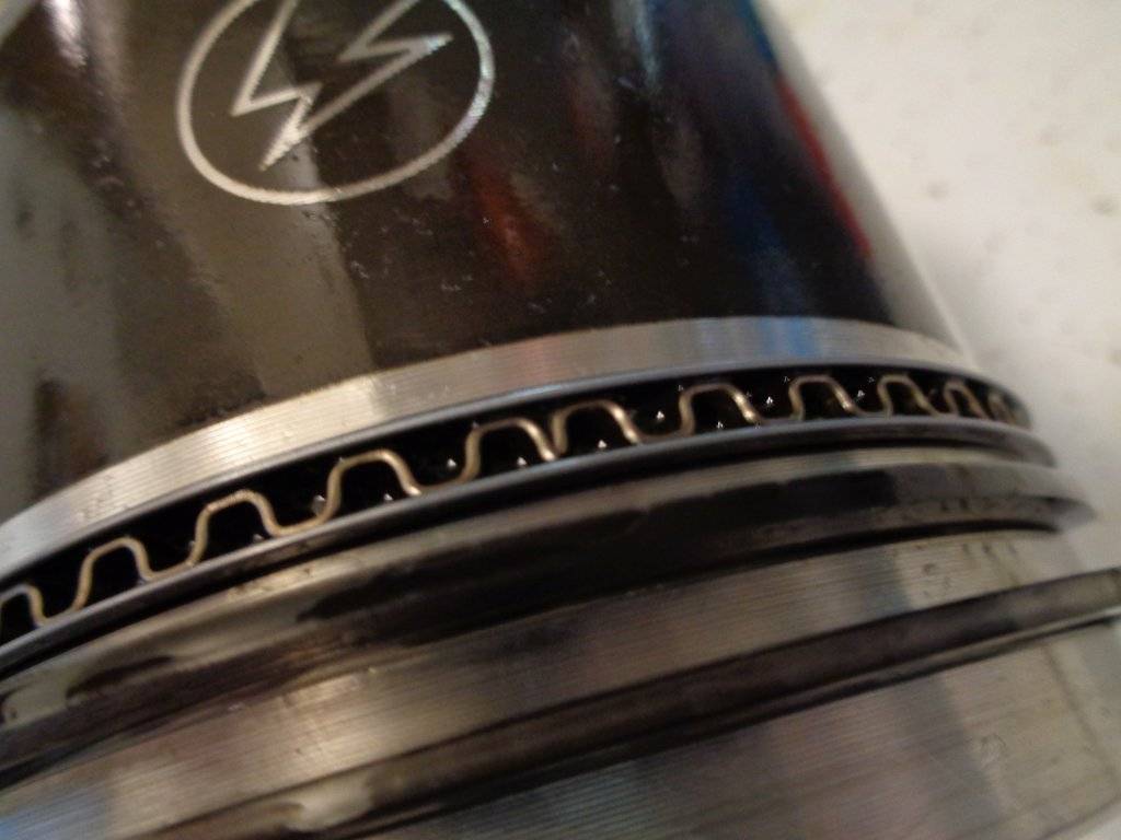

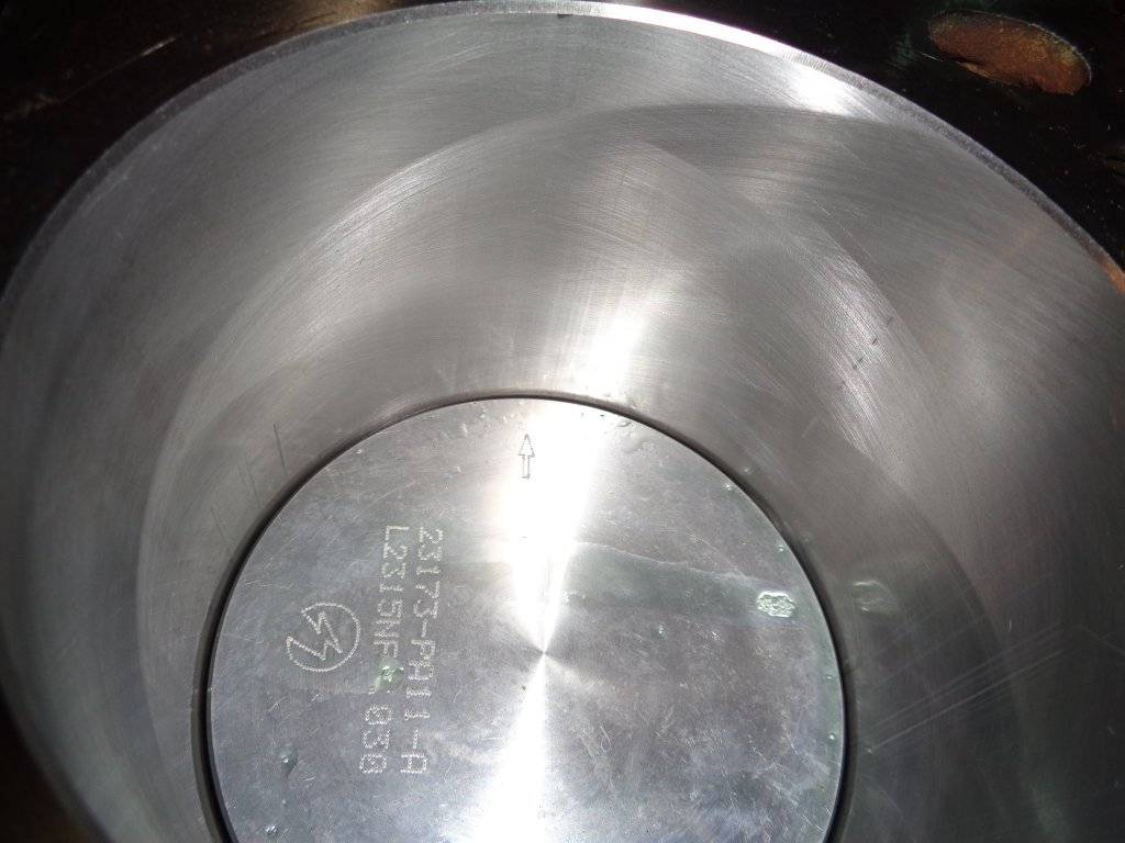

Why would it do this?
:wideyed::confused:
is the oil ring messing up?
I agree, based on the uniformity of the markings maybe the oil ring was not installed properly. Looks like the inner ring of the oil ring is making contact with the cylinder. The good thing is the scratches should not be that deep and if you pull that piston and fix it you can just reinstall and run it.
I agree with the above posts, but your engine looks dirty as well. If your oil is getting dirty running the piston through the motions it should cleaned. What is the debris on the deck surface?

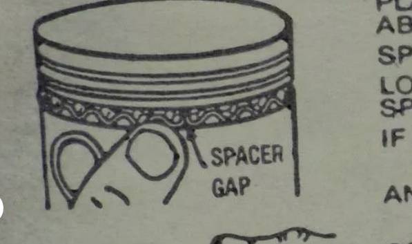

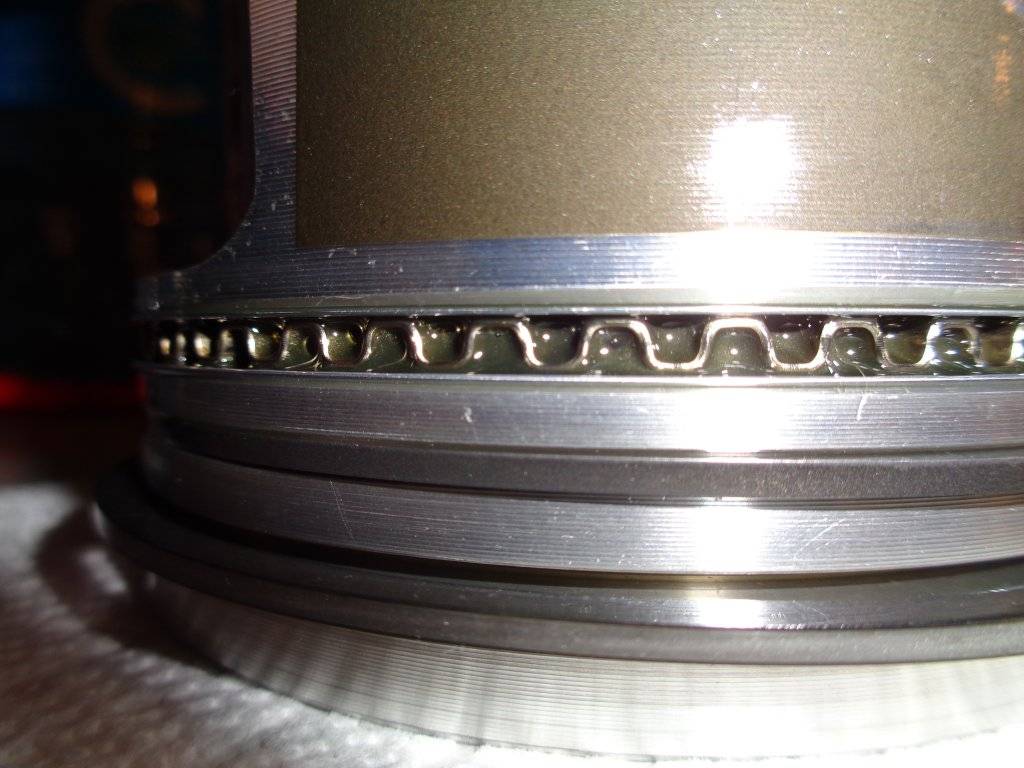

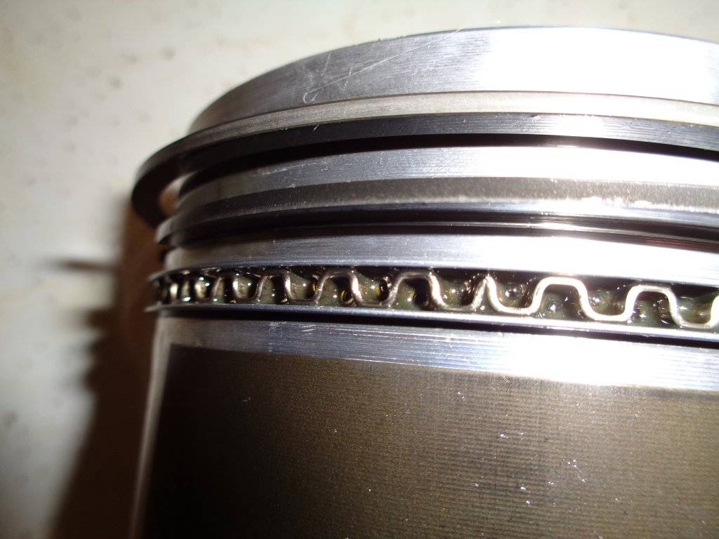

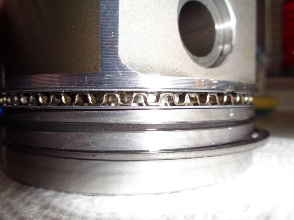

also I'm seeing conflicting information on the direction of the ends.
some say face them up, some say face them down.
mine appear to be facing up. I think thats what hastings said on the papers.
I cant find anything online for hastings but this useless garbage

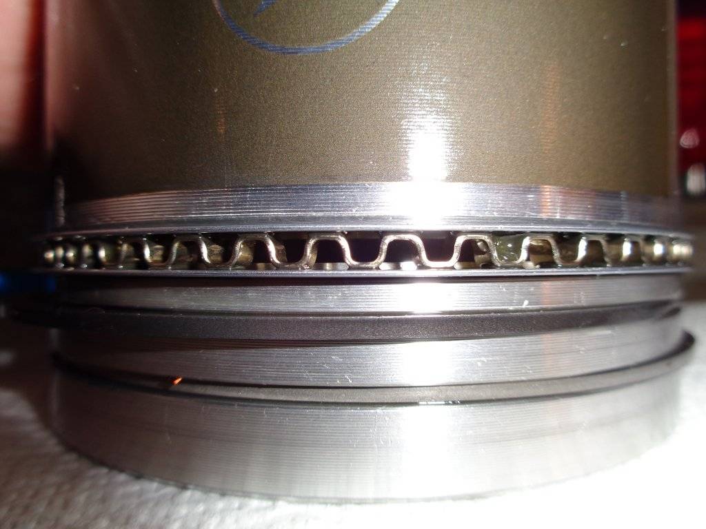

The first step is to place the spacer in the groove.
ya? what direction?
seems to the top is correct in my case thats how I put them

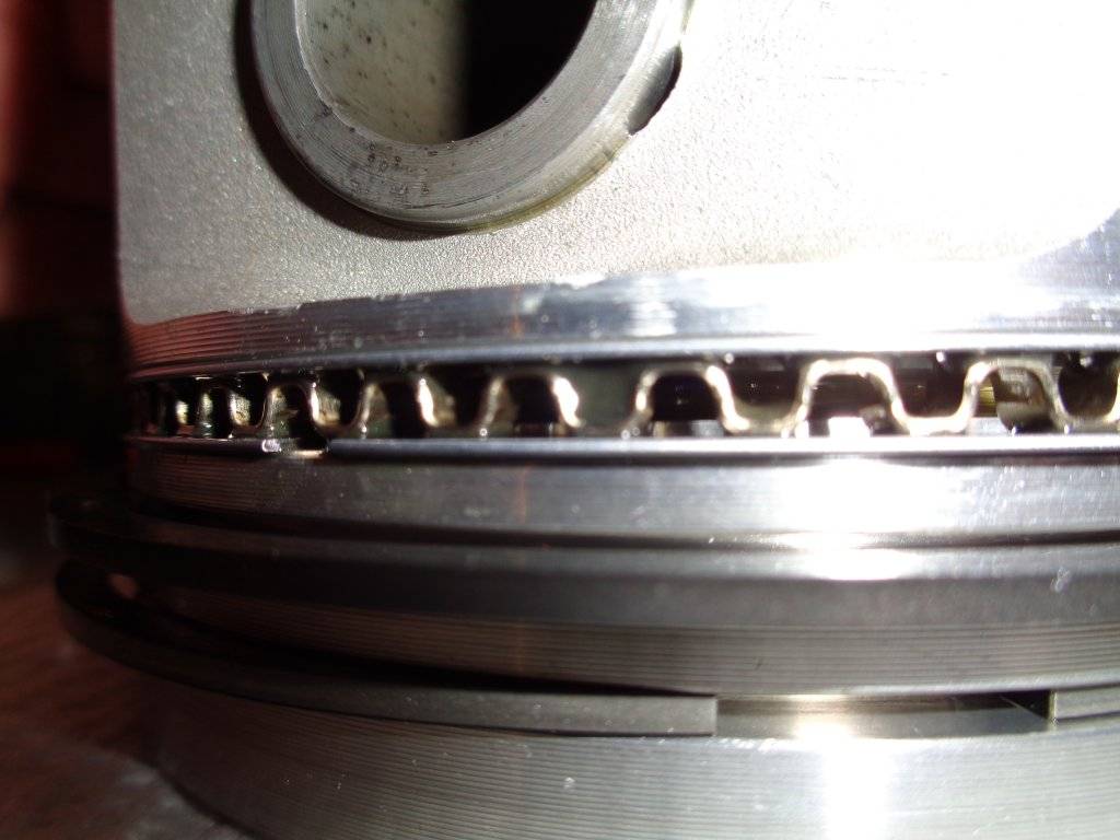

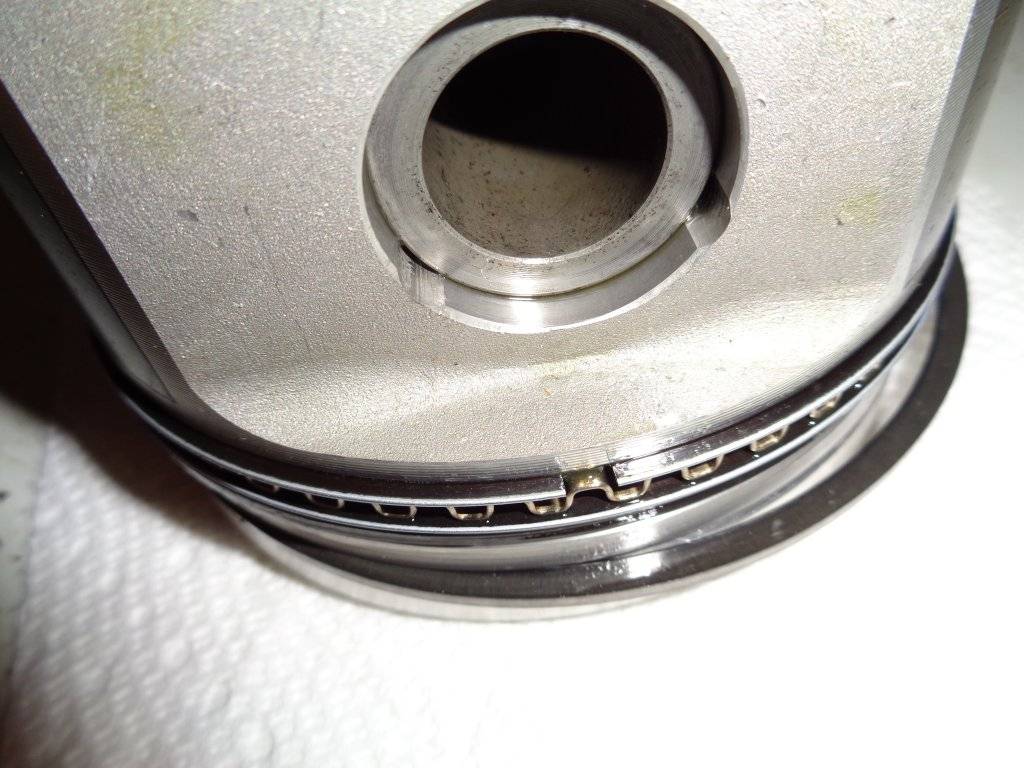

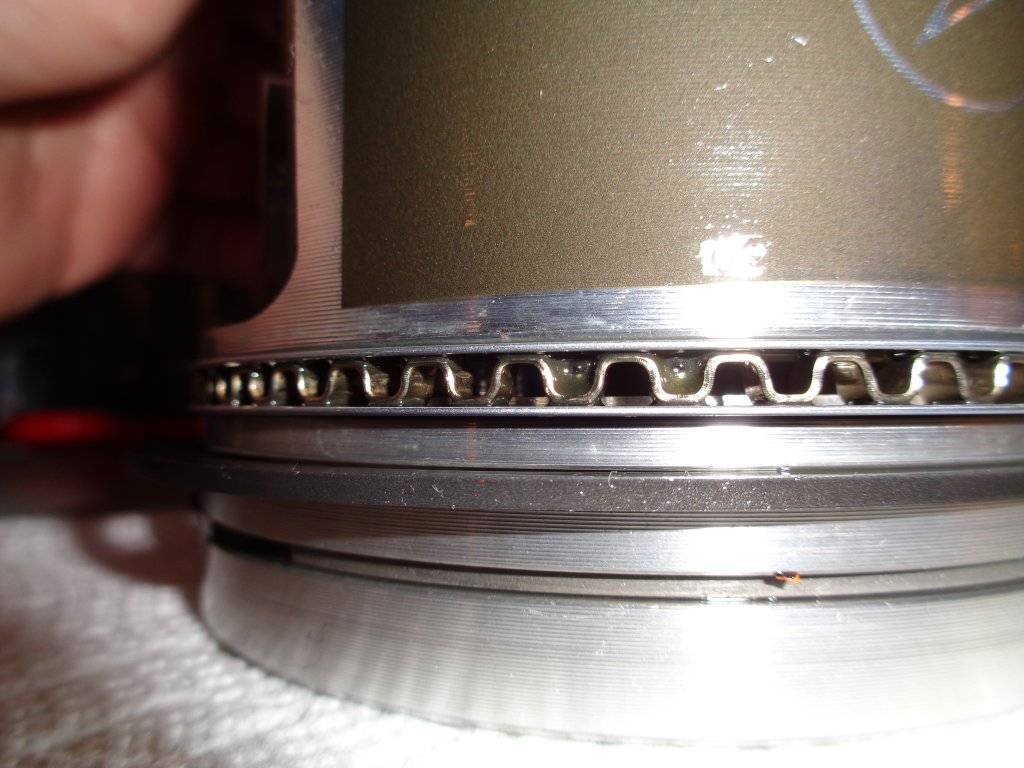

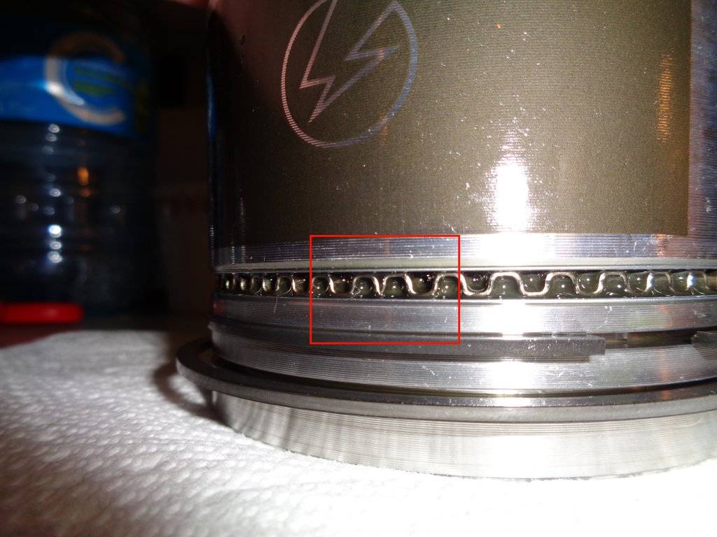

Just looking again, I am not sure if the expander was the issue or not.
It almost looks defective or something.
maybe it was that second compression ring?

I'm not feeling any burs or sharp edges on the rings.
I'm stumped. I guess I'm order a single set of rings and swap out the oil rings
I remember tring to put the oil scraper on first a time or 2. for some reason it didnt click into my head that the scrapers ride the shoulder made for them on the expander. for some reason I thought the expander just "resides" there. Its actually locked in with the upper and lower scraper. I am concerned now. I'm thinking I may have to check them all now
OK I got new rings for number 8.
any recomendations on what to use to clean up the scratches? the engine shop said debur them with red scotchbrite. I plan on having the motor upside down and rubbing the cylinders then brake clean and clean cloths to wipe it down so that way noting falls on the crank, just the open hole from the bottom...
