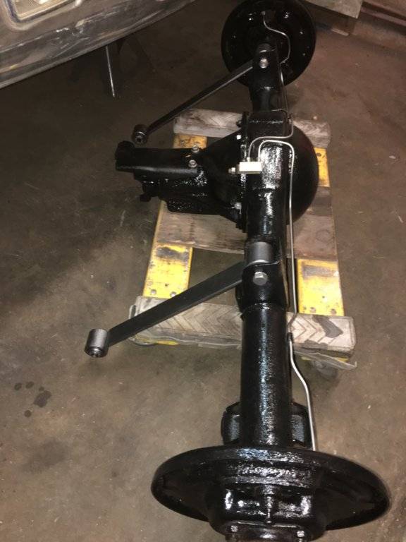

I have pictures of the parts installed but my phone's updating so I can't get them at the moment.
Here’s the rear- I’ll assemble the whole deal and snap a pic when I get to that part.
Thanks for the great pictures! Similar to the old Traction Master bars that bolted onto the bottom of the rear leaf springs' u-bolts. With a simple rubber-isolated parallelogram-style linkage to limit rear axle wind-up on hard acceleration. Many ads in the car magazines in the middle 1960s and, if I remember correctly, in some of the AMT plastic model kits, back then.

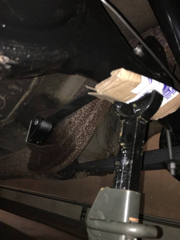

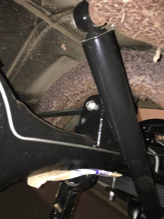

Lots of spending, not much enjoying yet but at least there’s forward progress... next steps are brakes and working forward to the transmission...
Here’s the axle installed- it uses shims under the frame brackets to set pinion angle. Pretty cool- and i’d imagine this car launches dead flat. I don’t think the snubber has ever touched the floor.
