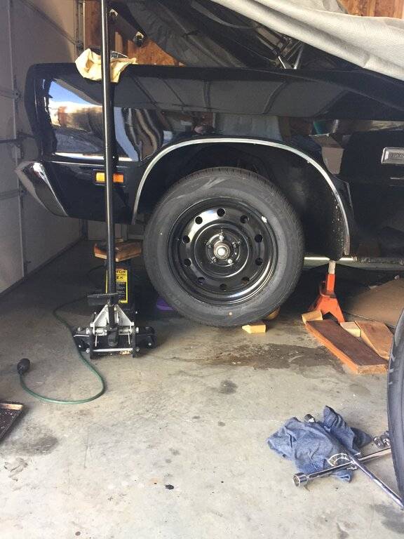

My spare on my 69 Fury was original and while it looks good it was the wrong size to match my 17" wheels/tires and the spare would likely not last on the road, so I needed another refreshed version. I tried to be normal person and find another mopar 15" wheel and while I found some I also found other options for less $$. For shits and giggles I looked for 17" wheel with the correct offset (being close to zero) and there are plenty of options if you are going aftermarket and are willing to spend $100+. I tried to find used but not much luck. After considerable searching I found that 17x7 newer Charger steel wheels fit and cost $50 brand new & delivered. Looks like prices have gone up a bit in link below.

The concern here is that the offset is +22 so 22mm towards the frame. That equates to roughly 5" backspace. In the end when I test fit on the front the tire was about 1" from the brake line on full lock so I was OK with that. Of course you cant get a big ol fat tire so I looked for the thinnest tire that was correct for my height (yours would be different) I got these for $60 delivered
Solar 4XS + P215/65R17 Tire - Walmart.com - Walmart.com
So in the end I got a brand new 17" wheel and tire for about $110 delivered. Kinda like a space saver but not that much. A little lighter I think.
