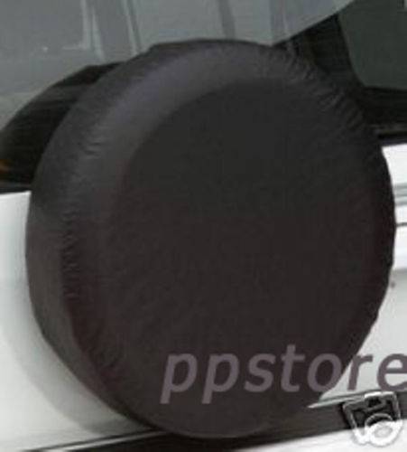

This is your answer for local car shows. I have one myself.
SPARE TIRE COVER 26.5"-28.6" NEW black 26" 27" 28" T021508PB 767344574986 | eBay or something similar... I just grabbed the first one I saw.
