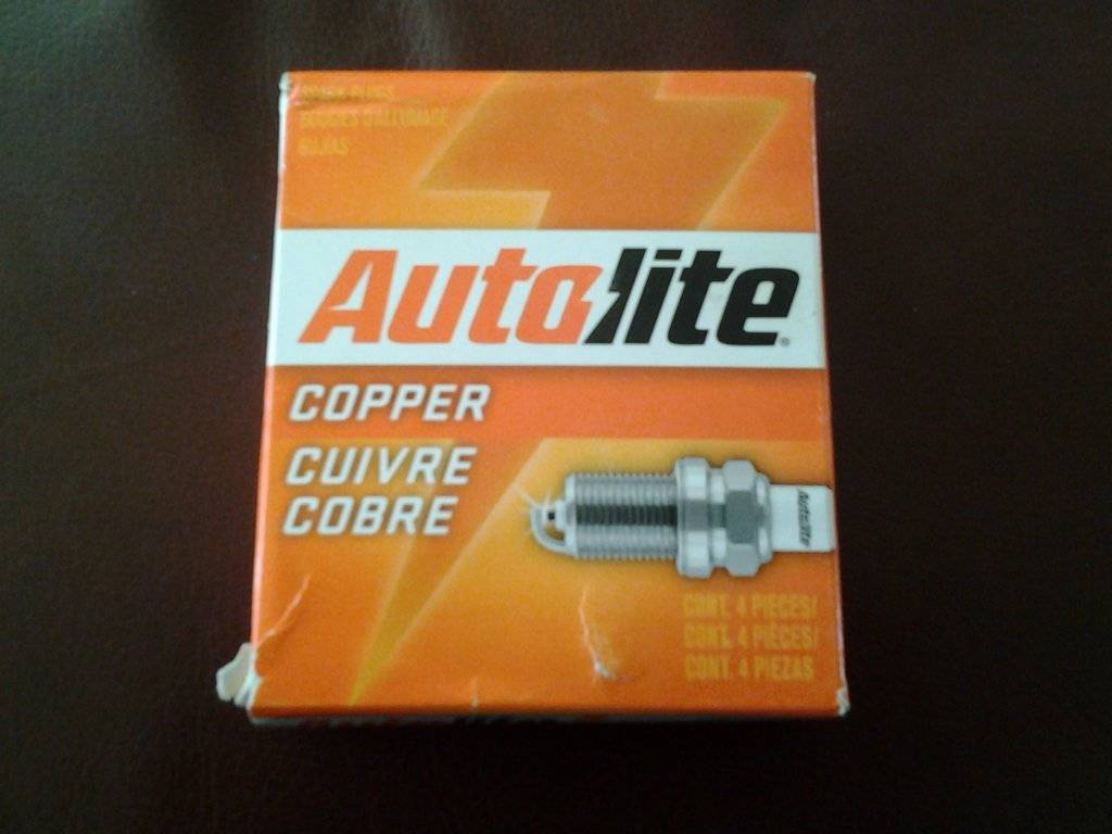

Thanks guys for all the info, i returned the 3405 champions at a cost of $7.20 I think those were for a small block ? Anyway i went to autozone and bought a set of autolite # 85 for $19.00 . Here is the strange part , they give me 2 boxes with 4 plugs in a box one box are silver with the crush washer attached and the other box are black steel with the washer in the box. Both boxes are the same with the number 85 on them, he said the plugs are the same ? I told him i don't care i want all silver so he exchanged the other 4 . Here is a picture of the box, i don't have one of the other box but the picture on it is black without the washer ?
An observed issue with NGK is that there are TWO numbers for ONE plug. The plug as an individual unit AND then as 4 plugs/box. So, you have to be careful about that, sometimes.
Used to be that all spark plugs were packaged in boxes of 8. If you needed one, you pulled one out of that box, leaving 7 behind. Good people would check the quantity before selling you that box! With the increased popularity of 4 cyl vehicles, easier to package them in boxes of 4 so there are more "full boxes" on the shelves.
