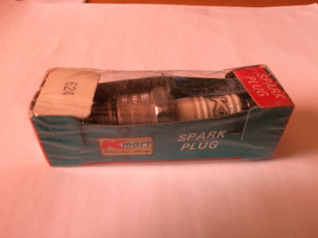

    Kmart 624's
    Jeff
    • Like Like x 2
    • Thanks! Thanks! x 1
  4. bigmoparjeff
    bigmoparjeff Senior Member
    Messages:
    2,035
    Likes Received:
    1288
    Joined:
    Aug 9, 2017
    Location:
    Dublin, PA
    Just Kidding. :lol:
    It was on my desk and I couldn't resist.
    I think the 624's are actually for a slant 6, but there are none out there for sale where I can find some kind of reference.
    Jeff

    No, I don't. Those would likely be from before my time.
    The one I photoed has a price of 56 cents, and it's probably from the early 1980's.
    Jeff
