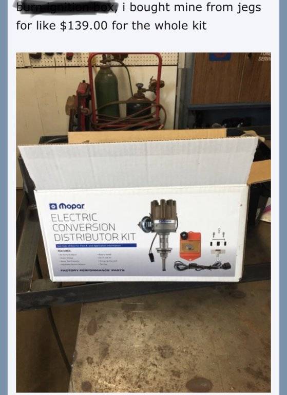

For future consideration:it’s never a bad idea to install electronic ignition , it will save you a lot time in tune ups . Here is a pic from another thread with the cost.
