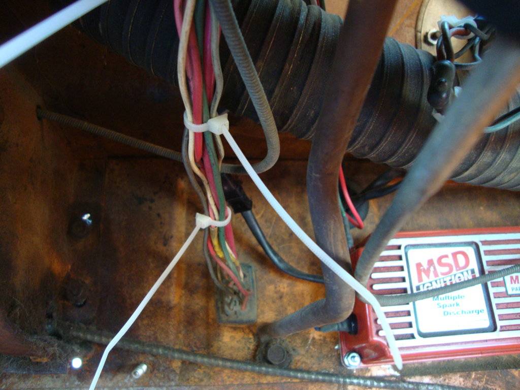

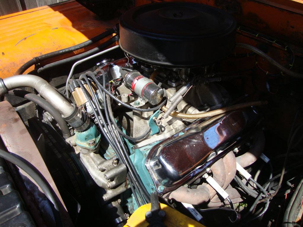

put my msd box under the dash , fed to the eng through the firewall with the rest of the wiring . the second is my d200 440 with an accel coil and chrysler electronic dizzy n orange box of course it had to be orange , lol .
