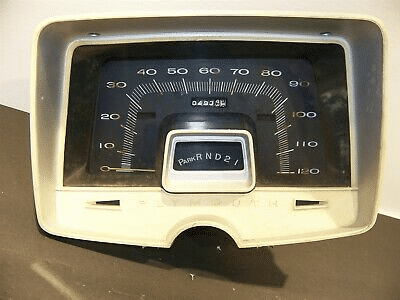

Trying to help someone out with their Speedometer Bezel. He thought he had a one out of a 1965 and 1966. Based upon the picture, I think it neither because I have both and it doesn't match either. Both the 65 and 66, but different, have the turn signals as part of the outside Chrome Bezel and not part of the speedometer face. Attached is a picture of the one that we are trying to identify; might be earlier, or later, that a 65 - 66 or for that matter, maybe it is the Canadian version. Thoughts and thanks!

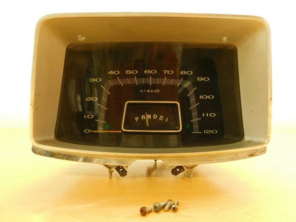

Looks very much like the one in my '66 Fury (Canadian). Not quite sure about the location of the upper screw holes- maybe just th picture. Lindsay

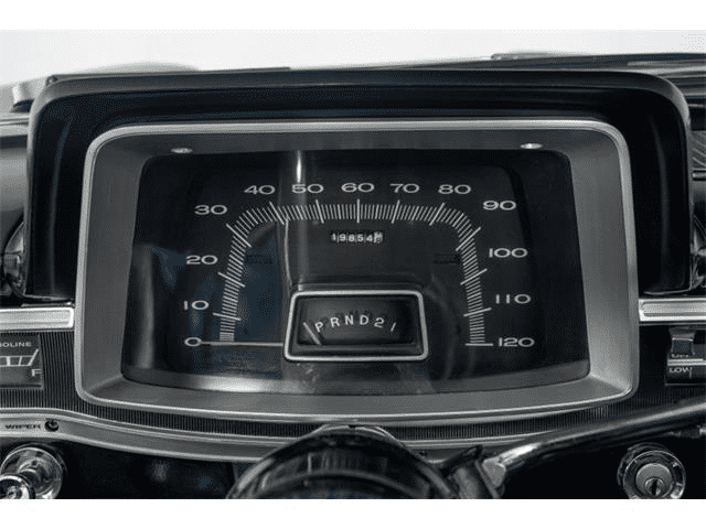

Your picture is of a 1966 Fury or Canadian Dodge Polara/Monaco speedometer.

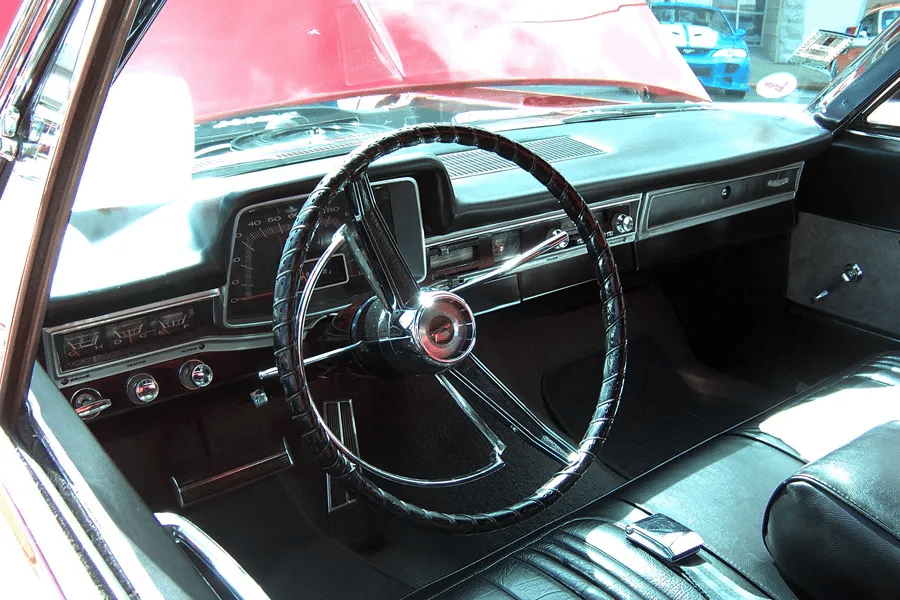

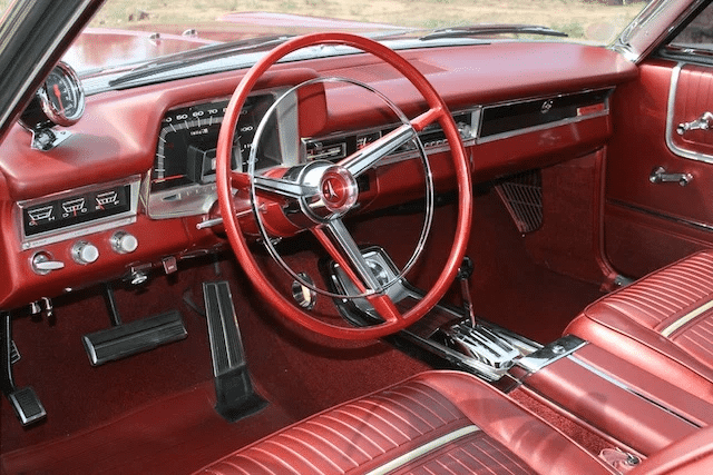

1965 had turn signals in the bezel, and the gauges and radio heater bezels did NOT extend underneath the speedo housing.
1966 Fury had turn signals in the speedo gauge itself, and the gauge bezel and radio/heater bezels had arms that extended UNDER the speedo housing.
While I've never tried it, apparently the 66 housing will fit in the 65 dash, but the 65 housing will not fit in the 66 dash because it interferes with the gauges and heater/radio bezels.
