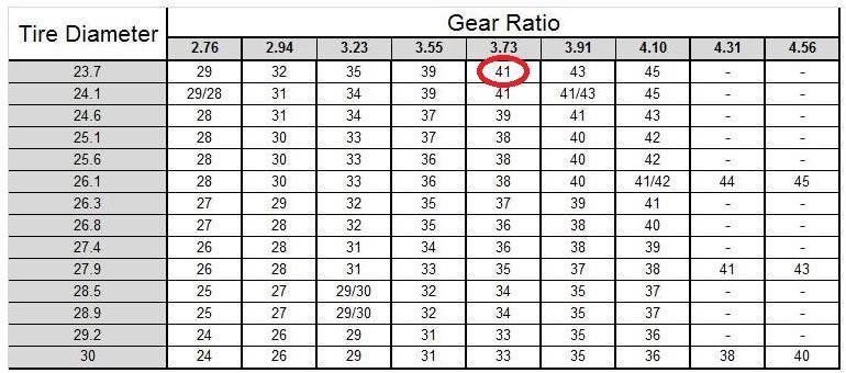

That sounds like a speedometer issue, but let's try something first.
You need to check the odometer... Pick a mile marker on the highway and note the odometer reading. Drive 10 miles (or more) and check it against another mile marker.
If the odometer is correct, it's the speedometer.. If the odometer is wrong about the same percentage, then you need to match the speedometer gear to tire size and rear axle ratio.
Pay no attention to the red circle... This is just a chart I found on the intrawebs.
