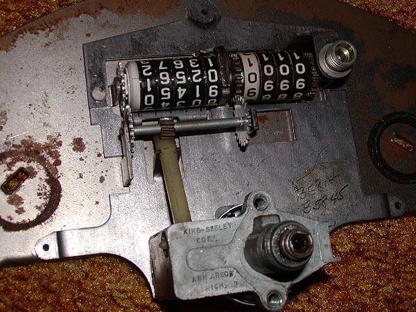

Not sure when they switched to the clip on speedo cable, but a '66 has a screw fitting at the speedometer end.
This is what a 65/66 one looks like once you tear into it.
The cable goes to the threaded fitting at the bottom. The odometer is a solid gear train. There is a horizontal plastic shaft/worm gear behind where it says "king-seely" that drives the visible vertical plastic shaft. The threaded fitting at the upper right is where the reset cable for the trip odometer goes.
The speedometer itself is a metal cup that surrounds a magnet that is spun by the cable. The magnetic attraction causes the cup to spin as well, but it has to work against a spring. The faster you go, the more force there is, so the needle moves farther.
Not sure about your noise, but what I've seen go wrong with these, is something hangs up in the trip odometer, and the plastic gears get chewed up.
