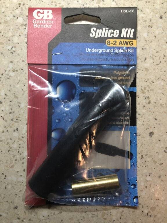

You could also a "split bolt". These are available in different sizes at your local hardware store.
