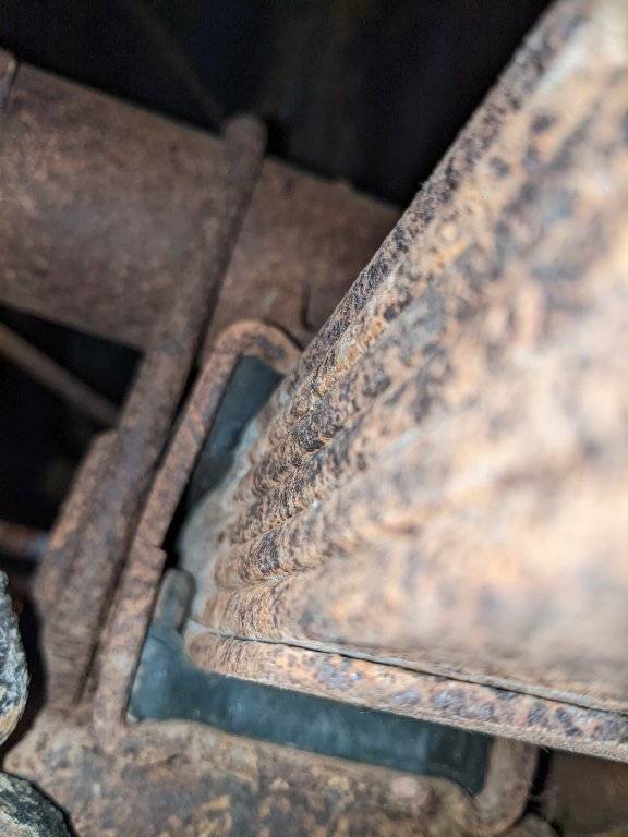

I'm wondering if the isolator can be deleted without welding on a new spring perch.
My 1971 Fury has a large centering opening for the isolator. Hard to get a pic.
Opening for isolated spring perch. Pic from 1972 8.75 rear
I think the 1970 and earlier had a much smaller opening at the spring perch

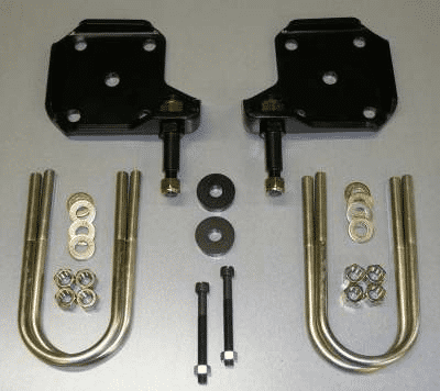

I would try using a round spacer that fits in the larger hole. If you clamp the spring, you can remove the bolt and add a large thick washer that fits, and it should work. If you have any spring shops in your area, they could help you with the U bolts and nuts and a larger bolt to hold the spring together. Look for a place that does truck springs. I would make some sort of spacer to replace the rubber insulator, so you keep the same ride height.
Looks like the center bolts, nuts, and washers give alignment.
Would I replace the center bolt of the leaf spring?
The center bolts in the leaf springs get replaced (not positive it was needed, but I did it), then the spacers (described as washers, they are super thick like a puck) fit in between the leaf spring and the upper isolator clamp in place of the rubber isolator.
