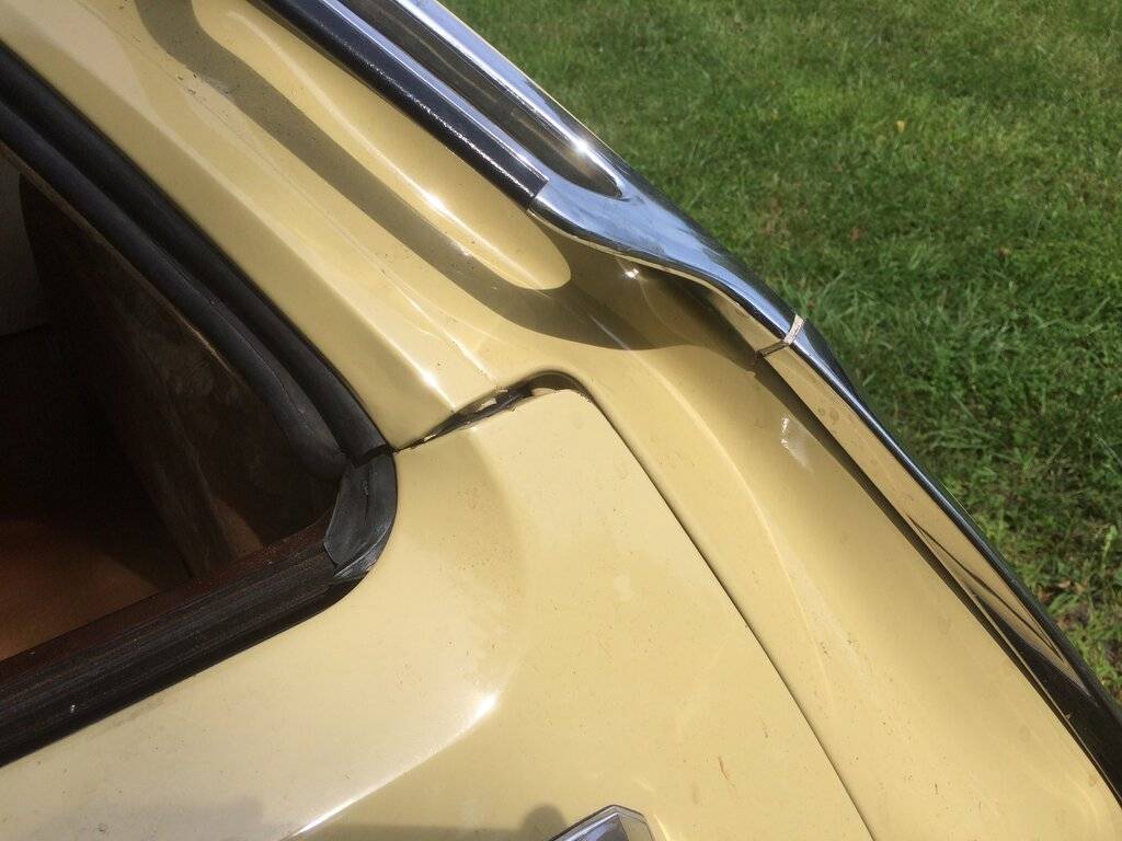

That one exception that I mentioned will make repairing the car much more difficult, and that's the left rear quarter. The quarter was hit back in the 70's or 80's, and it's a victim of the typical crap bodywork that they did in those days. When I rap on the panel with my knuckles, it sounds more like a fiberglass boat than a metal car, so the entire panel is basically carved out of mud. If it wasn't for that, I could use a roof panel off of any '72-'73 Plymouth, Dodge, or Chrysler, but since it needs a left quarter, I'll have to find a Plymouth donor to fix it.

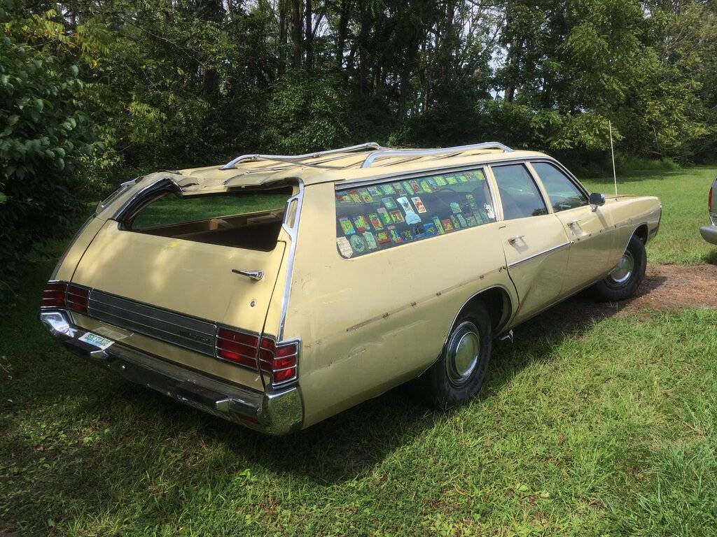

Tailgate won't open, as it's being squeezed by the crushed in quarter.

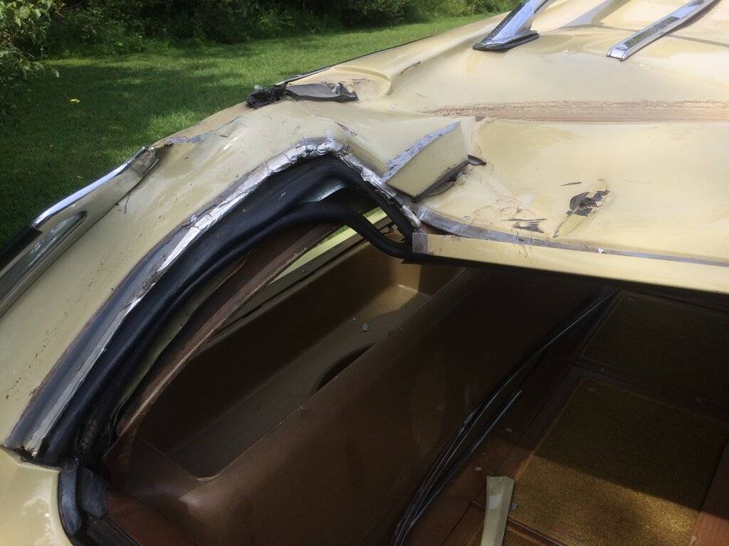

Hardest hit part of the car.
Mud in left quarter goes all the way up the D pillar.

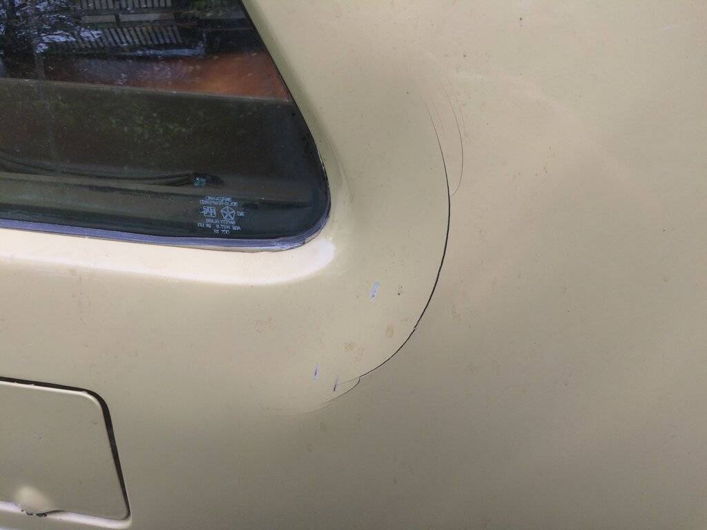

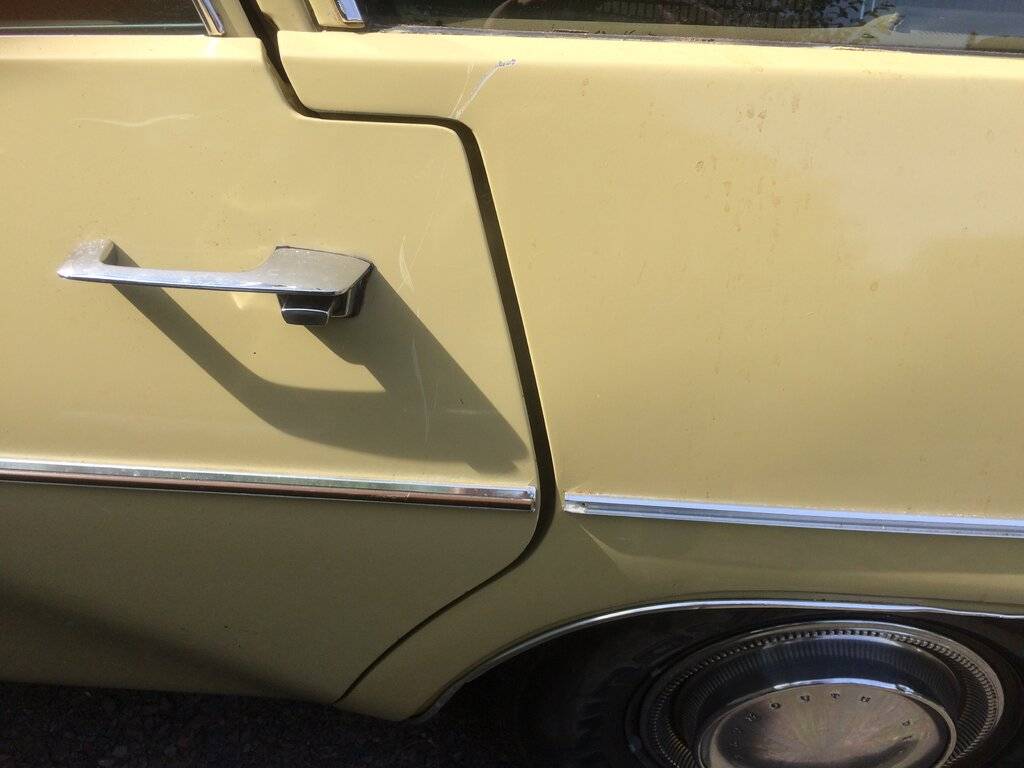

Door gap opened up from the tree hit, not the previous accident.

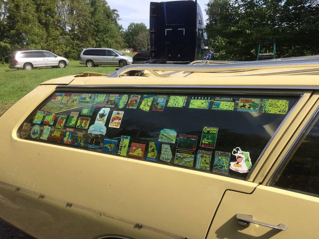

Travel sticker collection.

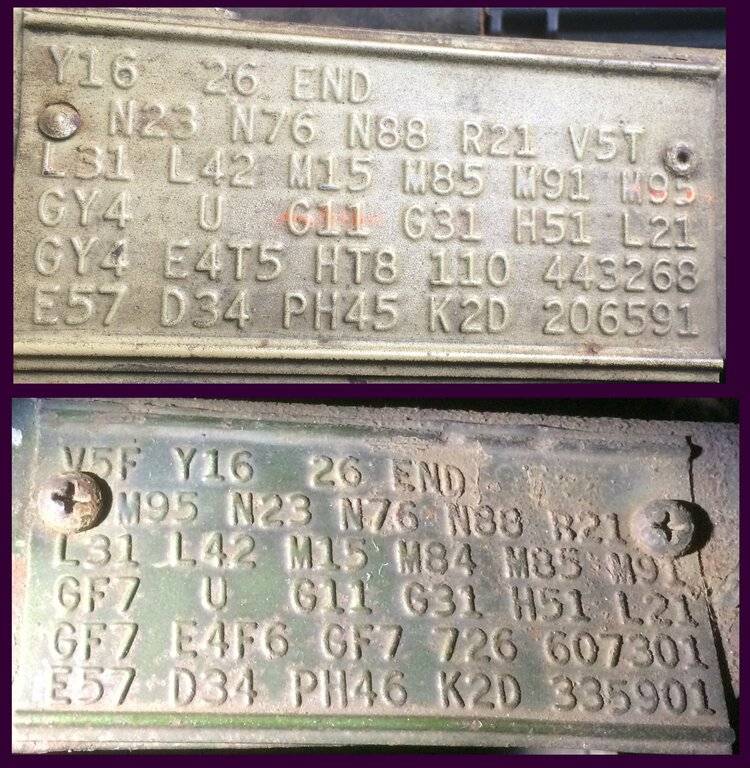

With the exception of colors, and the fact that my green '72 wagon is a 3 seater and the tan wagon is a 2 seater, they are optioned exactly the same, other than the M84 on the green one. I always thought that M codes were for mouldings and trim, so I'm not sure what that would be. Maybe something related to the 3rd seat?

I wonder how well you could straighten that roof out with a couple bottle jacks and 4x4 beams
If I had access to a frame rack, it's likely that it could be straightened, but when you consider the bad left quarter, I think replacement is the best way to go.
Jeff
Right, the correct way would be to replace all the metal. I was thinking in the meantime you could move things close enough to get that rear tailgate open and replace the window. Then you could enjoy driving it while you gather the proper parts.
