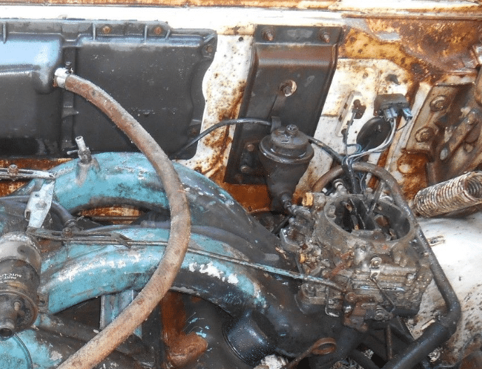

    That does not sound like a mopar number, so I am guessing you have an aftermarket unit. Does the car have an iron caliper mount (stock) of a mount fabricated out of steel plate? (aftermarket) Chrysler used mostly standard brakes on the '63-'64 cross ram cars, does your single pot master cylinder have a high dome on the cap? If so it is probably a'65-'66 disc brake master. The cross rams are a highly sought after collector piece, but as a practical matter, they were something of a pain in the butt. The engines had solid lifters which necessitated pulling the cross rams every time the valves need adjusting, about every 4-5k miles for street use. They also had a bad habit of burning out the aluminum heat tubes for the automatic chokes. But, cross rams are hard to beat as a conversation piece. I do not think there is an aftermarket power brake booster that will fit this application unless you plan to remove the cross ram setup. The 300 G was offered with power brakes, but those tubes were the "long" variety and had a different profile. See www.chrysler300club.com website has some photos of the power brake system on the 300 G in their archives.

    If you have an original Ram K, I'd think you'll be shooting yourself in the foot if you start messing with the existing booster in it's original location under the left fender, and disks on any Ram K. Your tapered rear axles require a special puller also just to get the drumz off without screwing them up, But their's no reason you can't run 15" wheel on your K if you chose, The title is in your name. Adjusted properly those '64 Drums work fine. If you need inspiration I'd suggest you think seriously about joining the 300 Club Int. Inc. and when you get your copy of the club roster contact Don C. up in Boston. He and his Black Ram K Convertible I believe are still the K Guru of the 300 club and he's good people and you will find him to be more then helpful, Jer.

    BigBarneyCars is right, only about one third of all 300k cars had the 390 horse cross ram setup. You do not want to mess with any of the stock equipment as these cars have good collector interest and are bringing premium prices if kept stock.

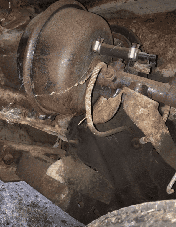

    The fender well booster in the in the photo was used on '63-'64 Letter cars that were power brake equipped. It is a "slave" type booster that is activated by fluid pressure from the firewall master cylinder, note the two brake lines attached to the slave master cylinder. One is from the firewall unit, the other goes to the cars brakes. This booster is very similar to the units used on GMC and International trucks. They used the same system with the booster mounted under the driver's seat on the frame rail. This is a different booster than the one used on the earlier letter cars G's and H's that was mounted directly below the firewall MC. In any case, these slave boosters were not really up to the task of disc brakes. Not sure if they made a later slave unit for some other application with discs that could be substituted.
