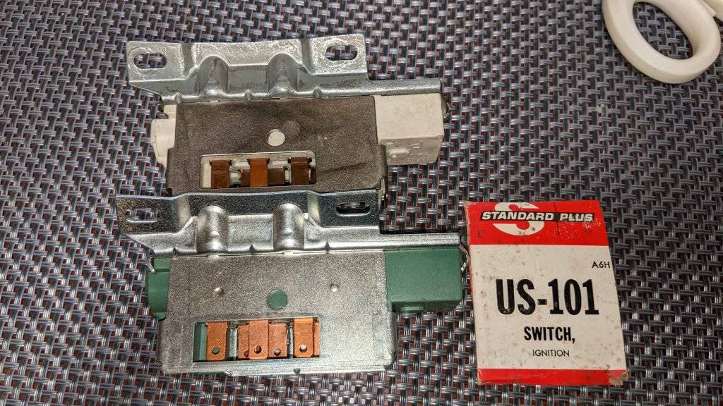

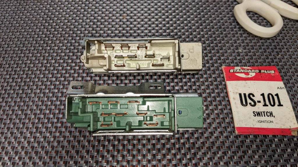

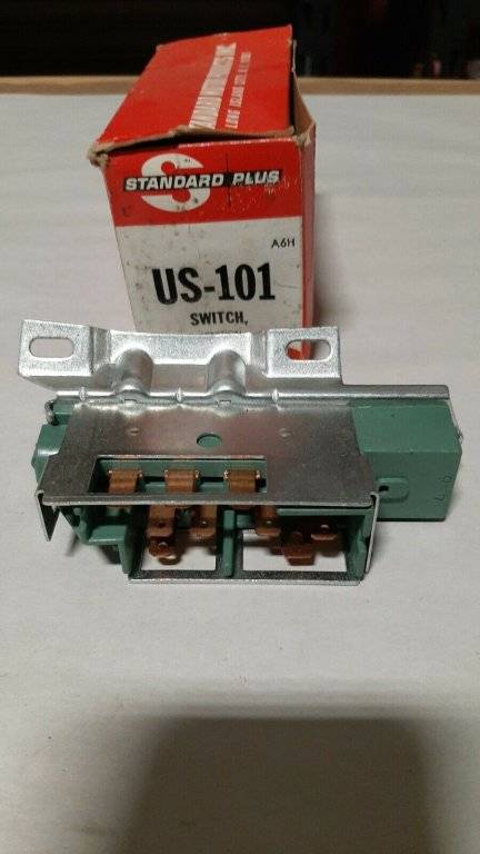

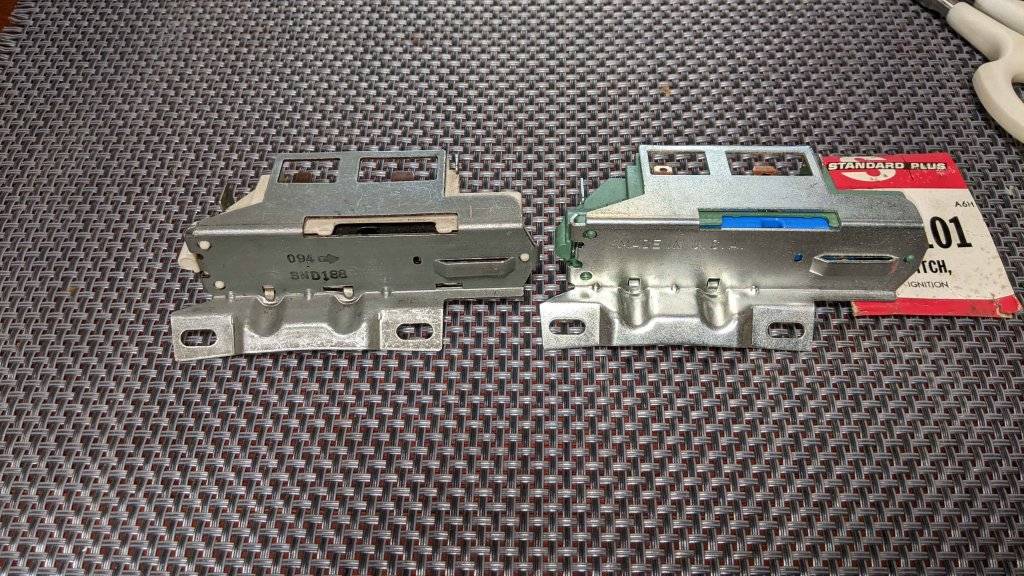

@DC118us Hi DC. I purchased Standard US-101 ignition switch NORS $27.14 ebay, includes tax and ship. Could not find original Mopar part # or Delco part # on ebay.
This is the one I purchased. Works excellent.
This switch is $23 on ebay now
Ignition Starter Switch-SWITCH and LOCK CYLINDER-IGNITION SWITCH Standard US-101 | eBay
Comparisons: Standard Green plastic to original, bare metal - wire connector burnt

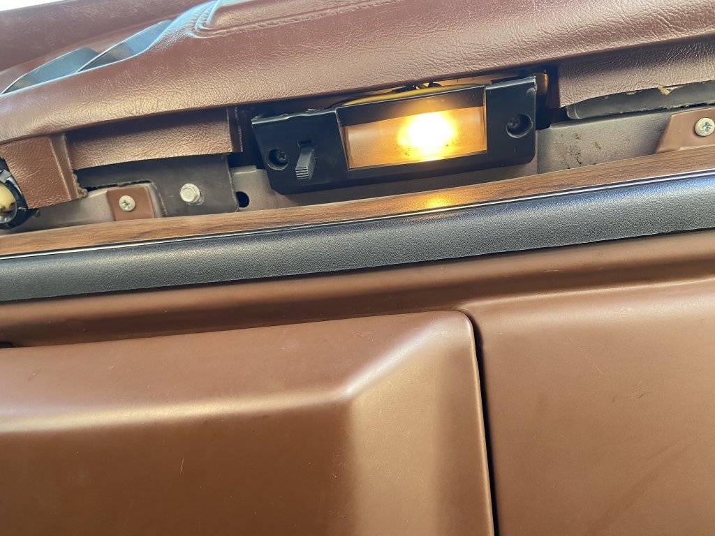

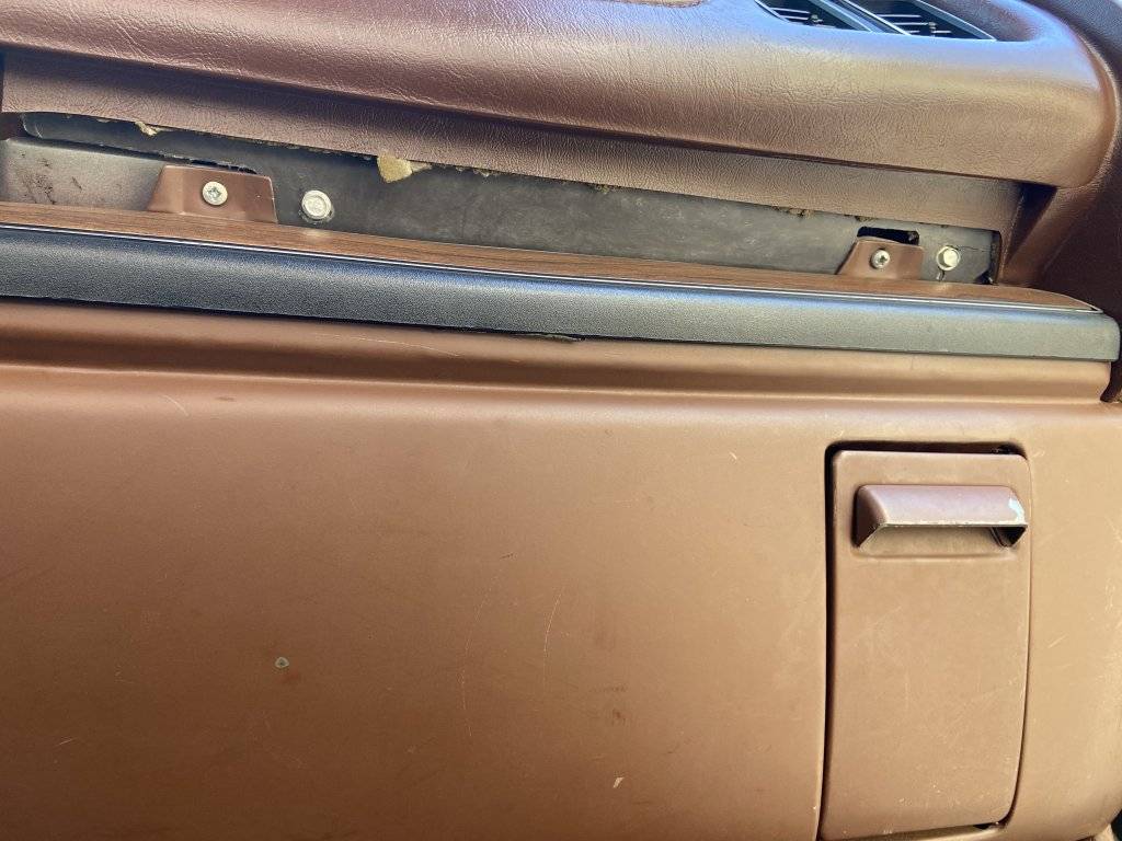

As I was laying on my back I noticed something. Is there a trim panel that is supposed to be over the passenger side mirror adjustment knob and light?
57fury440
Mar 17, 2019
348
335
Long Island, New York
It appears that there should be one but there doesn't look like there are any holes for the screws. Being that it is under where you can't see it maybe they felt it wasn't necessary.
