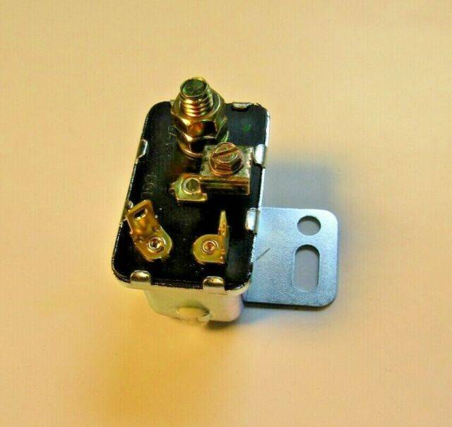

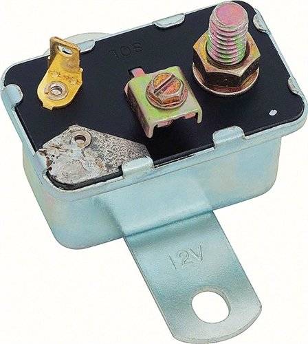

Not rocket surgery....
Manual trans relay Note the terminal in the corner is missing and in its place is a flat section soldered to the case. That provided ground.
Automatic
