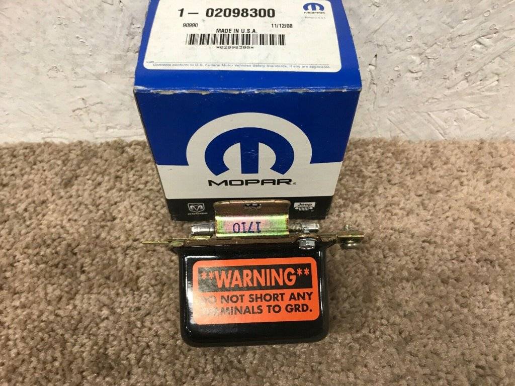

    Thanks for all the replies guys, super helpful and sorry for the late response. This weekend I plan on doing what 1970FuryConv suggested. And to answer the other questions it is an aftermarket electric ignition. To Stubs i believe its the older style voltage regulator(attached is a picture of the current voltage reg i have installed).

    That's the problem right there! I don't care what others say about the guts in those being newer/upgraded style regulators, they suck with electric ignig. You need the flat kind like in the diagram I posted if you don't want to have problems. People will say otherwise but they're wrong on that style of regulator, then they wonder why they have issues. Do what Big John said and report back. Good Luck

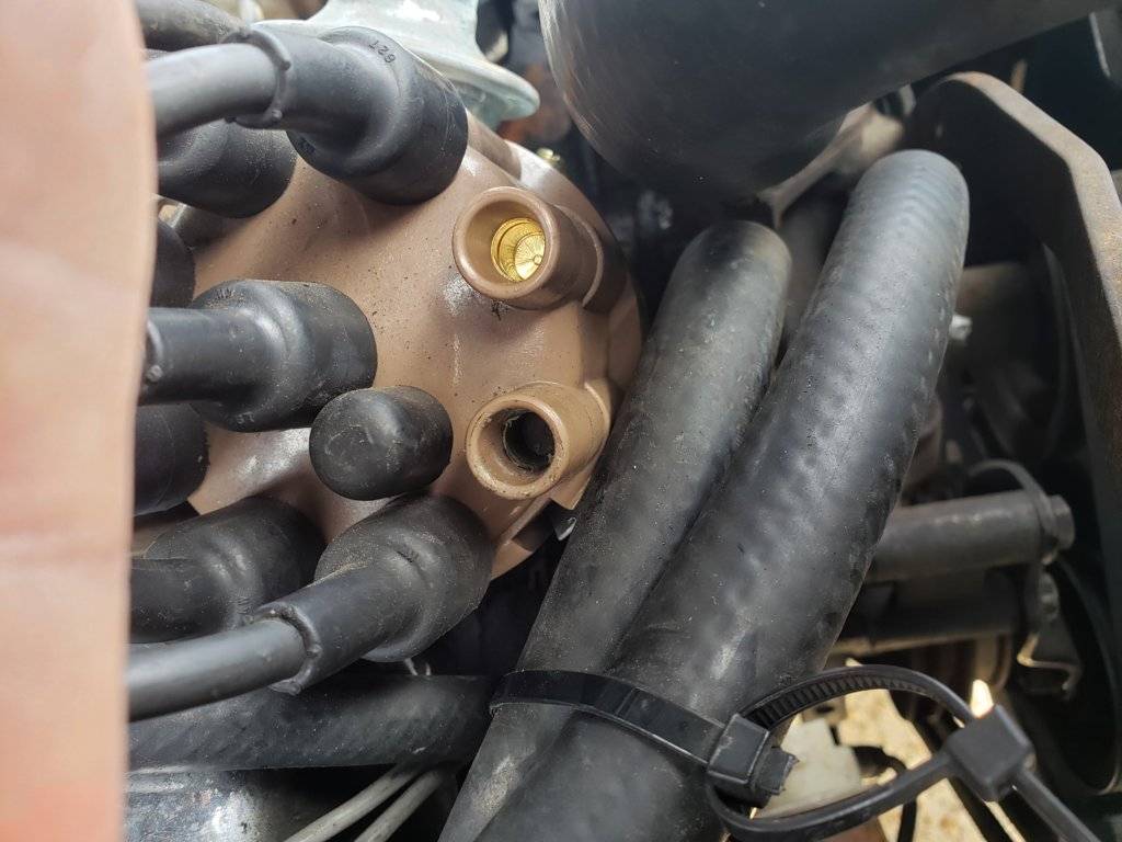

    Btw can anyone tell what distributor I have, based off the pic of the tan cap? There is no logo on it and doesn't seem factory to me

    That looks like a mechanical regulator to me, the electronic ones made in that style do not have the resistance bars underneath. This unit is not compatible with electronic ignition. The mechanical points opening and closing create static and the static shorts out the electronic components in the updated ignition system. Your distributor looks like a Mopar aftermarket replacement unit. If you remove the distributor there will usually be a distributor number stamped on the case of the unit.
