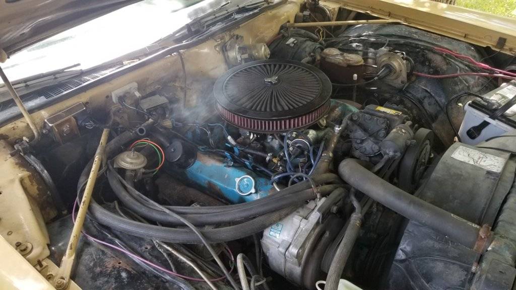

Has anyone had any experience installing a Electronic Ignition Kit from Mancini Racing to replace the Lean Burn on a 1978 NYer 440. I have installed it but she will not start/run. The starter will kick it over and the motor will spin up normally until the point where it should start. At that point, she bogs down and the motor practically stops. I acts like the advancement is too high.
I loosened the distributor hold down bracket and turned the distributor in to the far ends in both directions, it did not improve and it still bogged down.
My old distributor did not have a vacuum advance, but the new one does. Also, there is a capacitor wired to the Ignition coil, should this be removed?
I did not re-install any electrical connections to the Lean Burn and I left the old ballast resistor hook up as the instructions stated. I have double checked all the electrical connections, and we are good. Any constructive suggestions would be most appreciated.

Thank you for all the comments. The car did run well, but in temps over 80 F, the Lean Burn would fail to re-start or just die. The last time was at the C-Body meet in Volo, IL - quite embarrassing. I ordered the upgrade to eliminate this issue. There is plenty of gas in the carb and the fuel system is working fine. The carb is the original one put on at the factory, only 17 K on it (will need to be re-built due to leakage).
There is a braded grounding strap screwed to the firewall about 4 inches away from orange box ECU, I will attach a separate ground to the unit itself.
I think what may have occurred was the instructions stated to leave the Distributor and the Hold Down Bracket "loose". I may have had it too loose and it may have jump up enough to re-position the slot 180. Captain Newport's set up is just like mine (same color car - nice!) Somewhat tight quarters with the 100 amp alt, the RV2 and all the heater hose. Will give it another shot tonight.
Success! I followed Dave's advice and determined the rotor was not pointing to the #1 plug wire on the cap, it was pointing to #8, one spot over. When I was installing distributor, I had to do quite a bit of maneuvering and must have messed it up. It starts really well; now I have to set the timing and find a ported vacuum line to connect the vacuum advance on the distributor. The original distributor did not have one.
