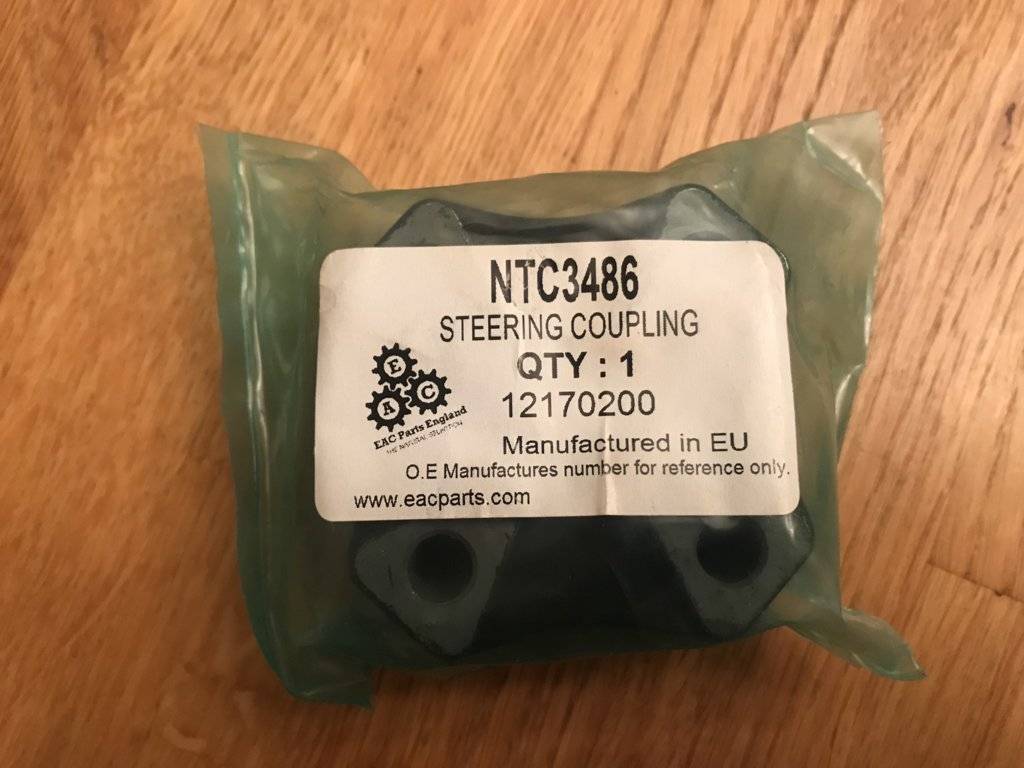

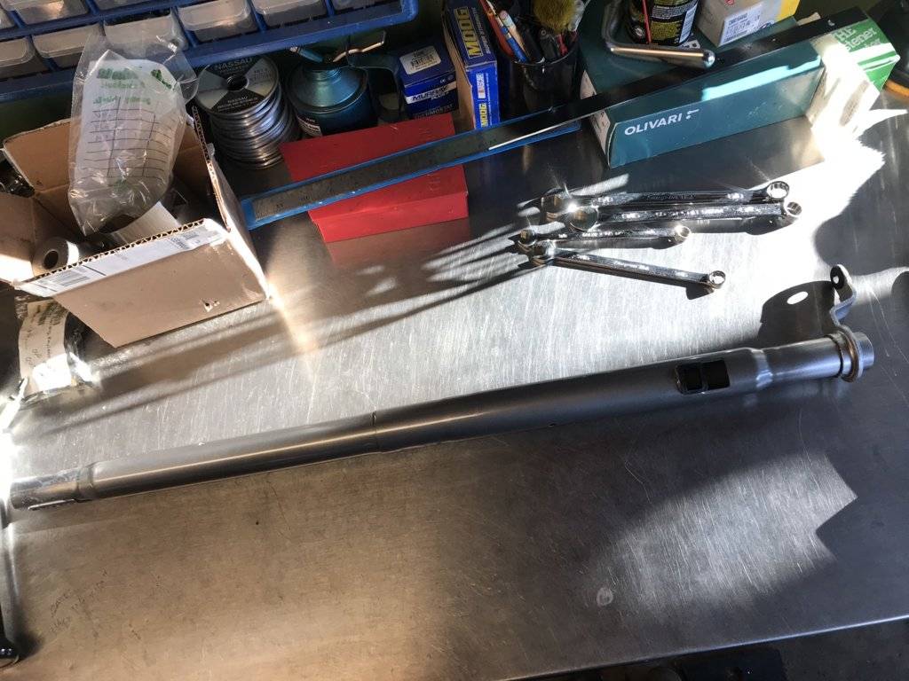

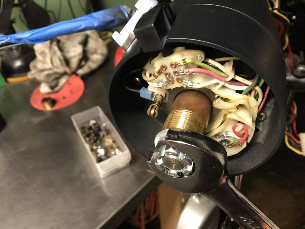

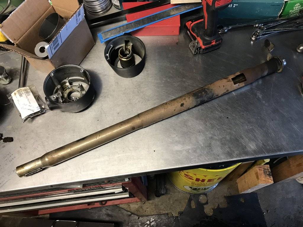

Well it was finally my turn to have a round with that rubber coupler. Thanks to previous members' trials on the subject, the Land Rover part worked for me too. Atlantic British hooked me up. One thing let to another and the whole column got rebuilt since it was out:

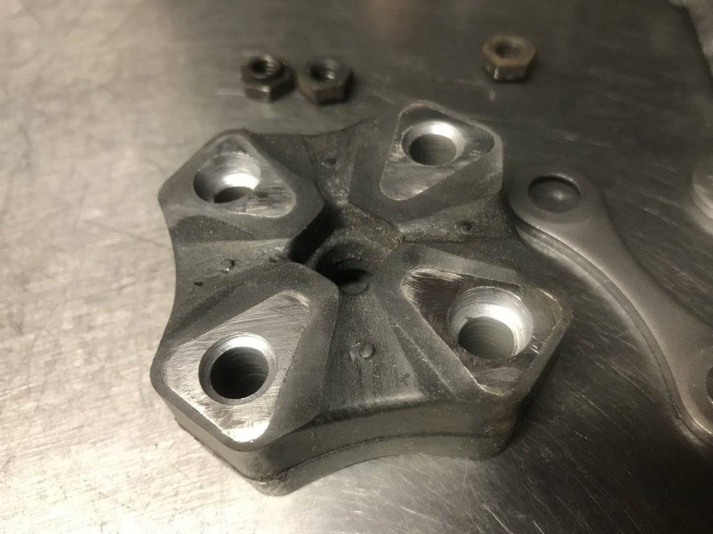

I bought a pot coupling rebuild kit from DMT, however all I needed was the rubber. The original metal parts were all good, including the spring clip. The OEM grease was still pretty much intact as well.

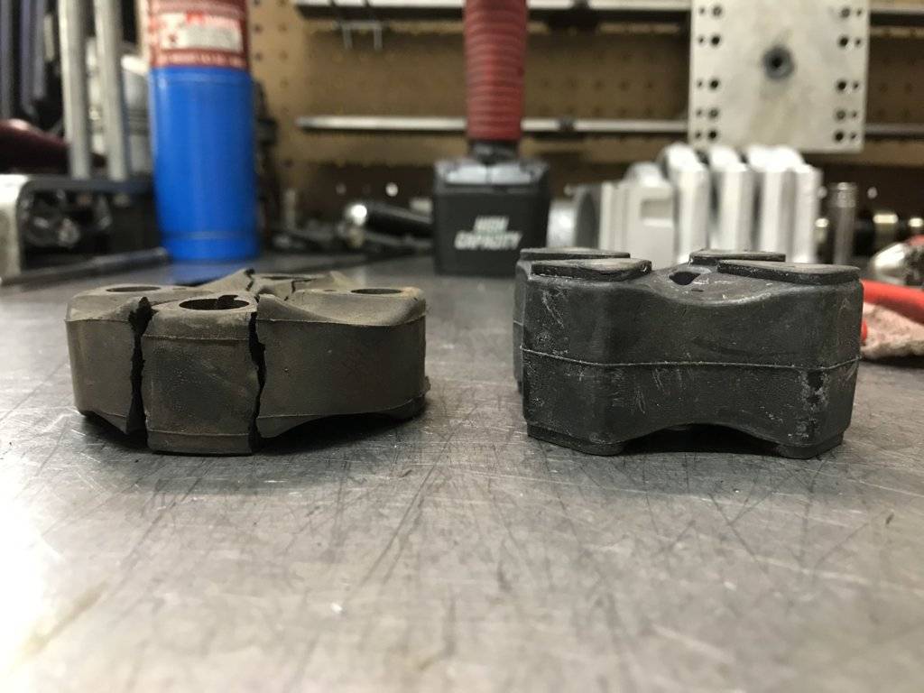

Used a grinder to make the new rubber coupler the same thickness as original. Ground 1/8" off ea/ side.

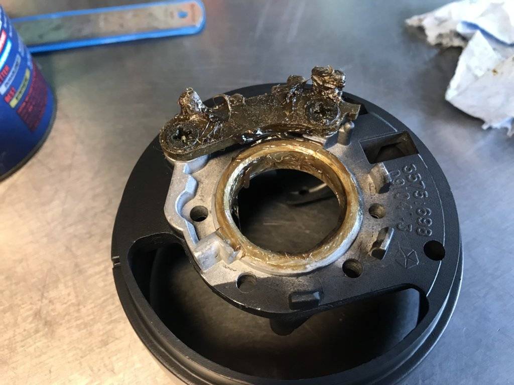

Counter bores drilled in new coupler, and other original parts cleaned up nicely.

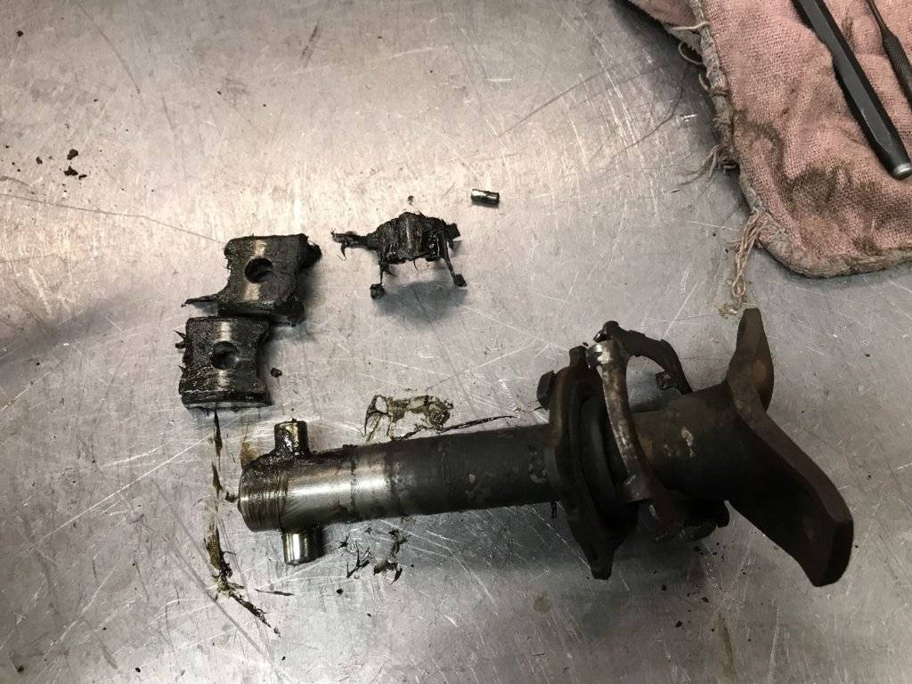

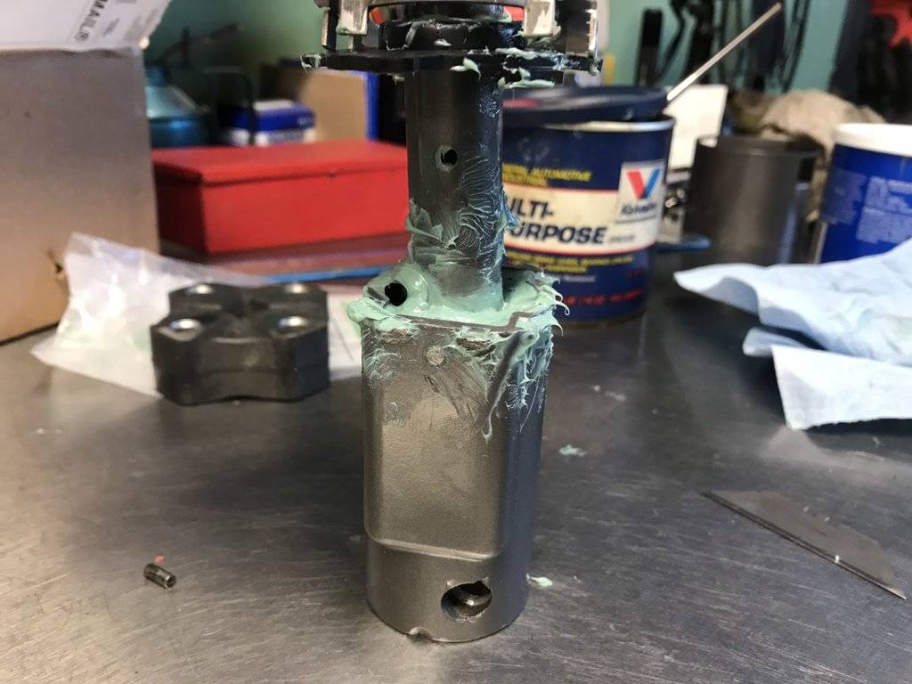

The pot coupling was painted and reassembled with marine grease. Man, that new stainless clip was a B**** to get to stay on. I used the auxiliary wire clip too.

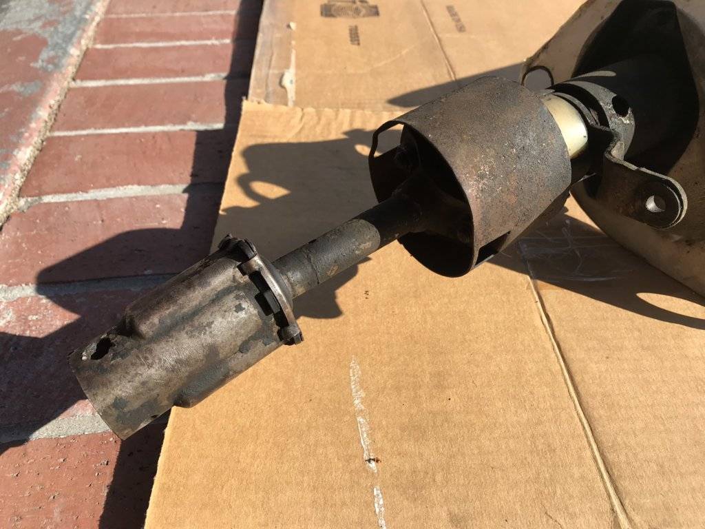

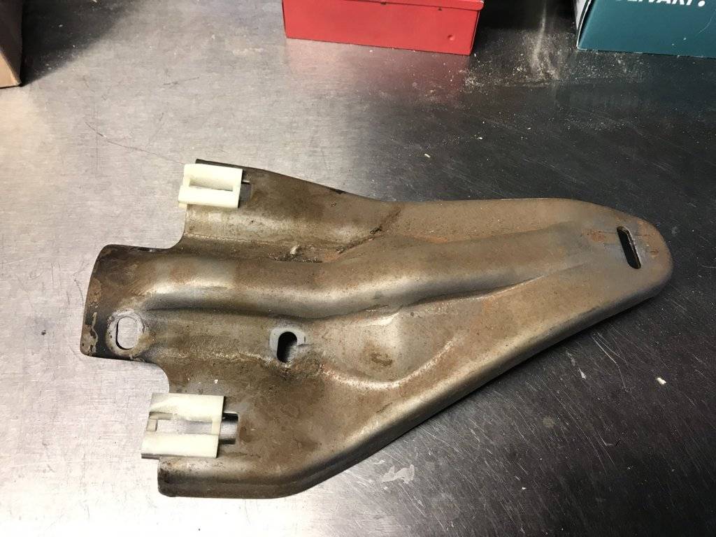

Column to dash bracket was bare metal, with very light surface rust, however it cleaned up with some phosphoric acid metal prep. Bare metal it remains.
Bottom bearing was in great shape, it was washed in solvent and re-greased.

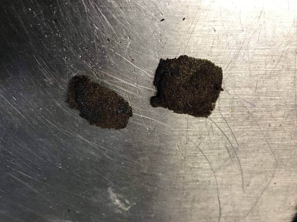

The foam seal, however was almost nonexistent...

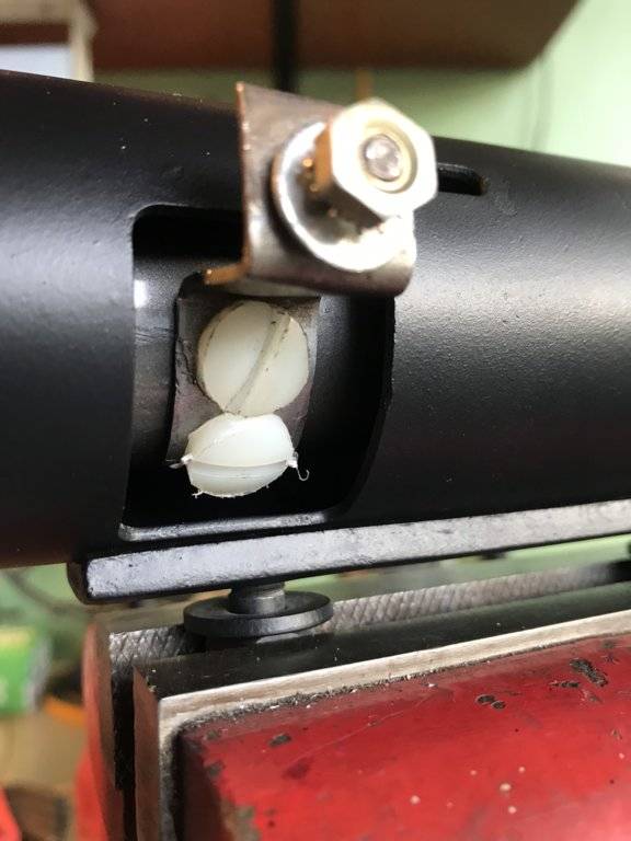

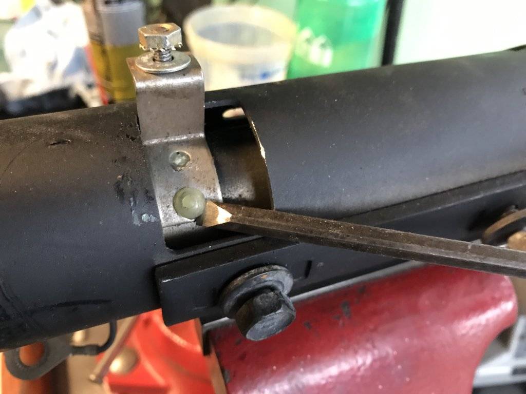

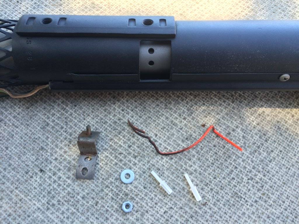

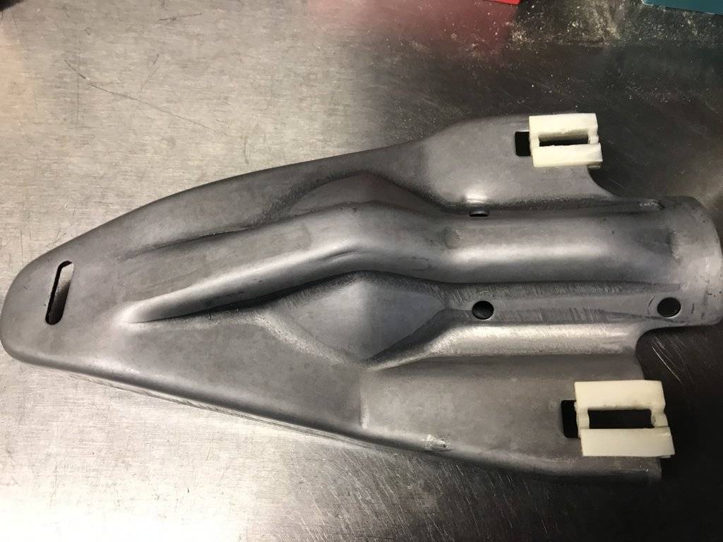

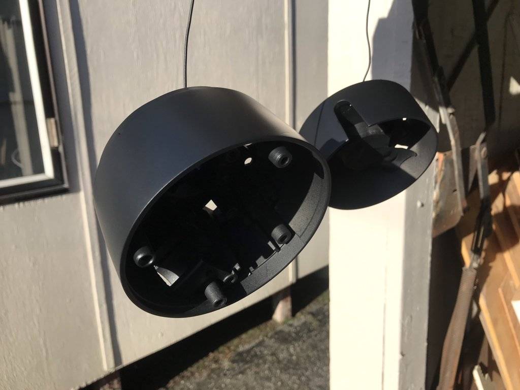

Thanks for posting. I have four columns I’ve been intending to make one good one, these photos are a huge help. I’m curious about the plastic screws, can you expand on what you did there and what you used to replace them?
McMaster-Carr has the nylon rivets (Rivets\Push-In\Pin-Lock Shank) I probably have 40+ more (no idea where), I don't recall what size they were and I had to trim the inside fingers a little.
These are 1/4" nylon screws i picked up at the hardware store. I tapped the shift tube to accept, as these are slightly larger than the original nylon rivets. I had to grind the heads to fit on the outside and snip the ends for clearance to the steering shaft. I like Alan's rivets better, but I didn't want to wait for anything in the mail, and these are hidden.
I get McMaster-Carr orders the next day if I get my order in by about 3:00, otherwise the following day, never more.

Manufactured in the EU, that's a new one! Nice!
