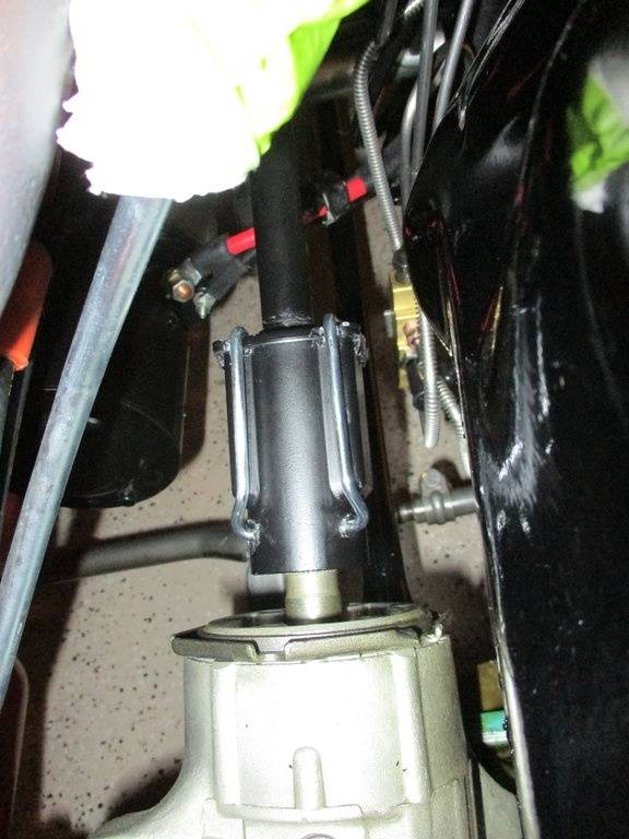

Gav, havent used that one, but I have used Ehrenberg's with great success in the GTXer.
OEM Mopar Steering Pot Coupler Repair Kit STOP the SLOP© W/ Instructions Dodge+ | eBay
Now, a very good Mopar friend of mine recommended this in conjunction with any coupler rebuild
Mopar A B E Body 3" 66-73 STAINLESS Steering Column Coupler Cover Clamp / Retainer
I havent used it, but I will once I get around to the GTXer.
I think the extra clip/retainer was something Chrysler had dealership mechanics add when they repaired the steering coupler. I saw it used on a couple cars, but no rhyme or reason that I could see.
I was just thinking that. Not really sure how the housing could move forward enough once installed on the input shaft to have it matter... the blocks and the pin can only come out the back... unless I'm missing the point entirely.
Ive been told the extra clip was so the top seal would not work itself free and pop off and let loose the shims etc. Insurance if you will.

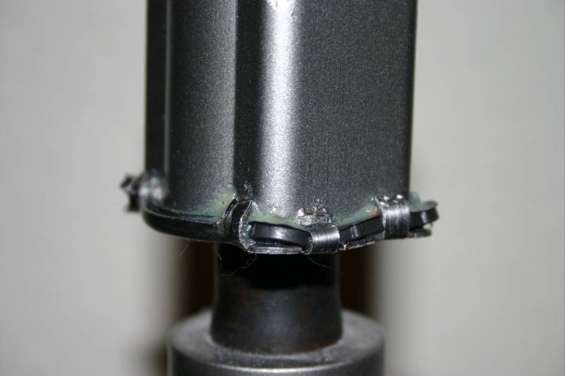

The cover will never come off is installed correctly, the one on my Barracuda will take a hammer and chisel to pry off.
To install correctly the column must be removed from the car.
1. Bend all the tabs on the cover at about the halfway point 45°
2. Assemble, grease etc.
3. Clamp tight (I was able to get a couple c-clamps on mine)
4. With a drift/punch drive all the tabs in and down over the nubs on the housing.
Alan

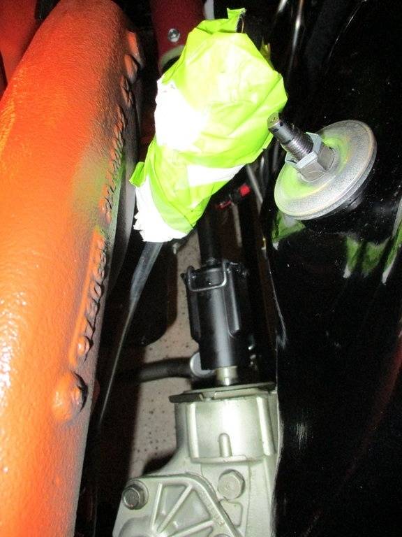

Actually, just the coupler only can be removed - remove the cotter pins and undo the fasteners at the rubber donut, and drive the roll pin out at the steering box.
Make a small allignment mark with a scribe on the steering box and the coupler ring (where the roll pin is, so you can put it back on at the same place or your steering wheel will be off by a bit), lift the coupler away from the rubber donut so the coupler can slide up. Then with a small pry bar push the couple up and off the spline from the steering box.
As far as I know the coupler can only go on one way as there is an indexing spline.
When I said the column needs to be removed I was referring to the column assembly needs to be removed, the steering shaft can remain in the assembly to service the coupler.
The assembly with the couple before servicing
Coupler showing the amount of compression needed to get a solid crimp and shows tabs being bent and crimped (ignore the one tab getting pinched in under the housing. As I said, this will not come apart.
Alan
Interesting - my 66 has no indexing spline at the box. The wheel does, but the box does not. Perhaps that changed with other years. An allignment mark still helps.
