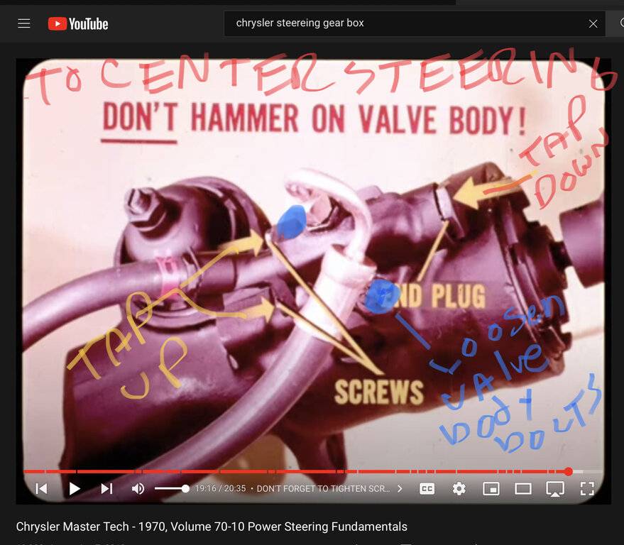

I’m pretty sure I know what the fix is. I just went through this. It’s a sensitive simple adjustment on the valve body of the steering gear, just did this my car was pulling hard right after installing a rebuilt steering gearbox. After I did this simply adjustment the car rides true and straight again. Watch the 2 vids below to understand this adjustment.
watch this one from 18:26 onward towards the end of the vid.
And watch this one in its entirety.
In the second video the only thing he’s wrong about is according to the Chrysler video your only allowed to tap on the end plug and bottom screws either up or down to center the valve body pressure to center the steering. Watch the 2 videos and you’ll understand. :thumbsup:
